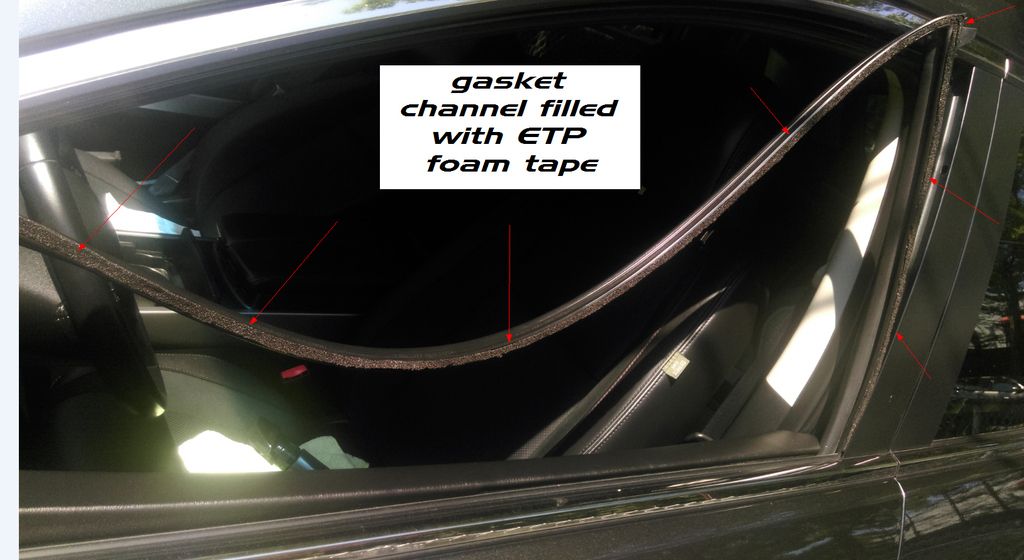

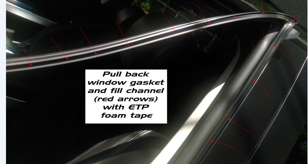

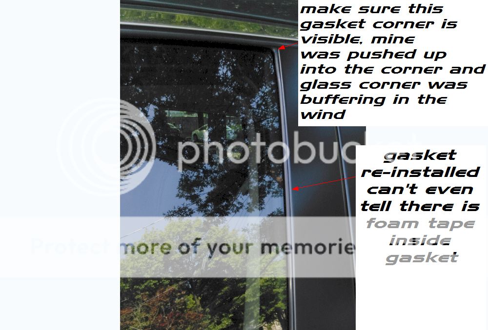

I figured out it was the B-pillar upper right corner of the driver side glass when looking from the outside, the gasket was deformed and pushed into the corner so the right corner of the glass basically was not sealed.
This is also a common problem with 2013-2015 Accords, so I used their solution to solve my problem, it really works
I hope this helps anyone else with the same problem

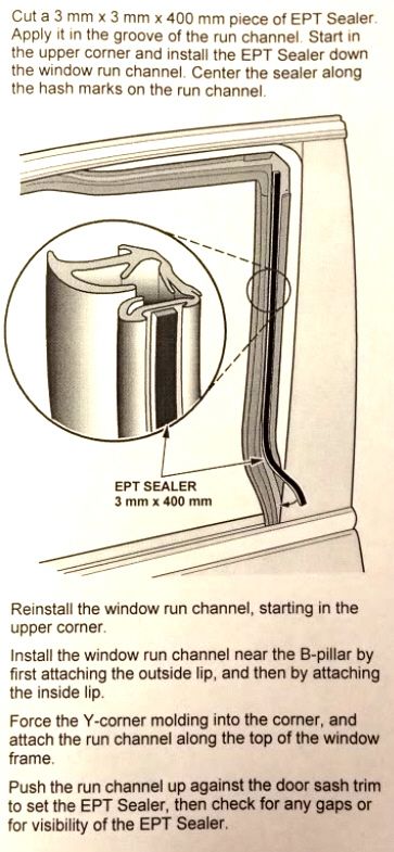

Honda part number: 06990-SA5-000 EPT foam sealer
here are pictures of my CX-9 using the foam tape, the basic idea is to provide a tight seal around the window top edge:
