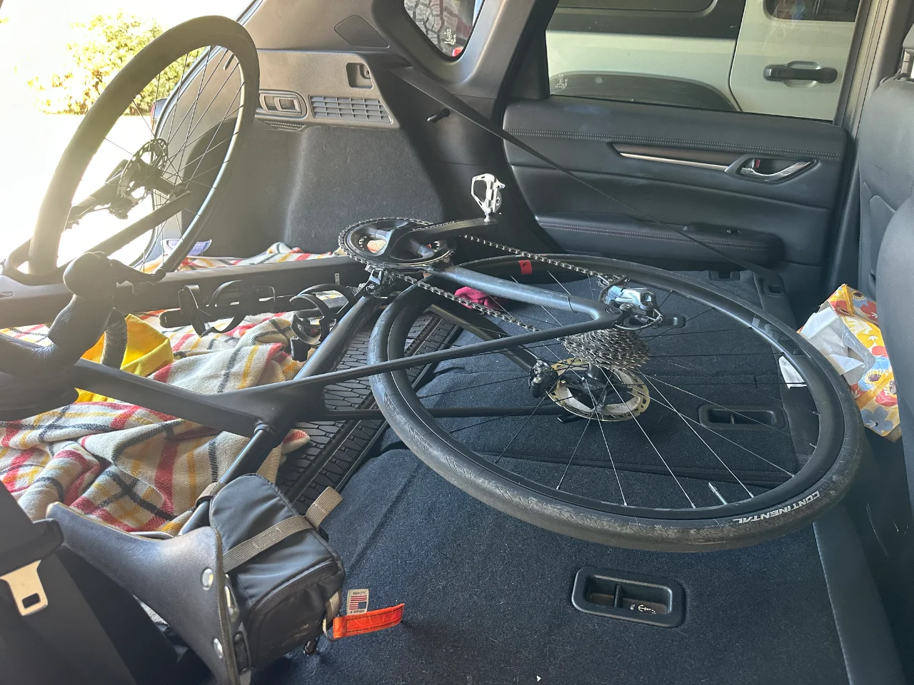

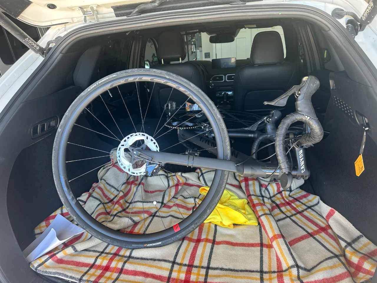

I have a 54cm Trek Madonne carbon fiber road bike, 700x23c wheels/tires. It fits just fine in the back of my 2014 with the front wheel on. If anything, based on your description of being tall, you might need to lower your seat post. I put the rear wheel in first, drive side up, and angle it to the drivers side rear door. Once it's in as far as it can go, I then angle the front of the bike to the passenger side with the handlebars turned so the front wheel is facing up (as if turning right) and set it in. No problems whatsoever. Lots of room left for pump, helmet, shoes, etc.
Make sure you check your brakes (if rim type) when you take it out to be sure they are free as sometimes they move and contact the rim when the bike is laying down. You can always bring your bike and a blanket to the dealership to try before you buy. They shouldn't have an issue with that for a potential customer. Again, mine is a 2014, Gen 1, but I don't think the dimensions in the back have changed. Hope that helps.
