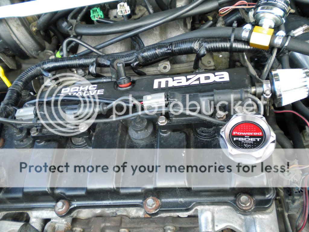

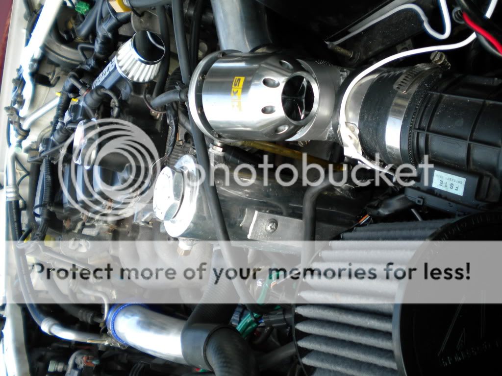

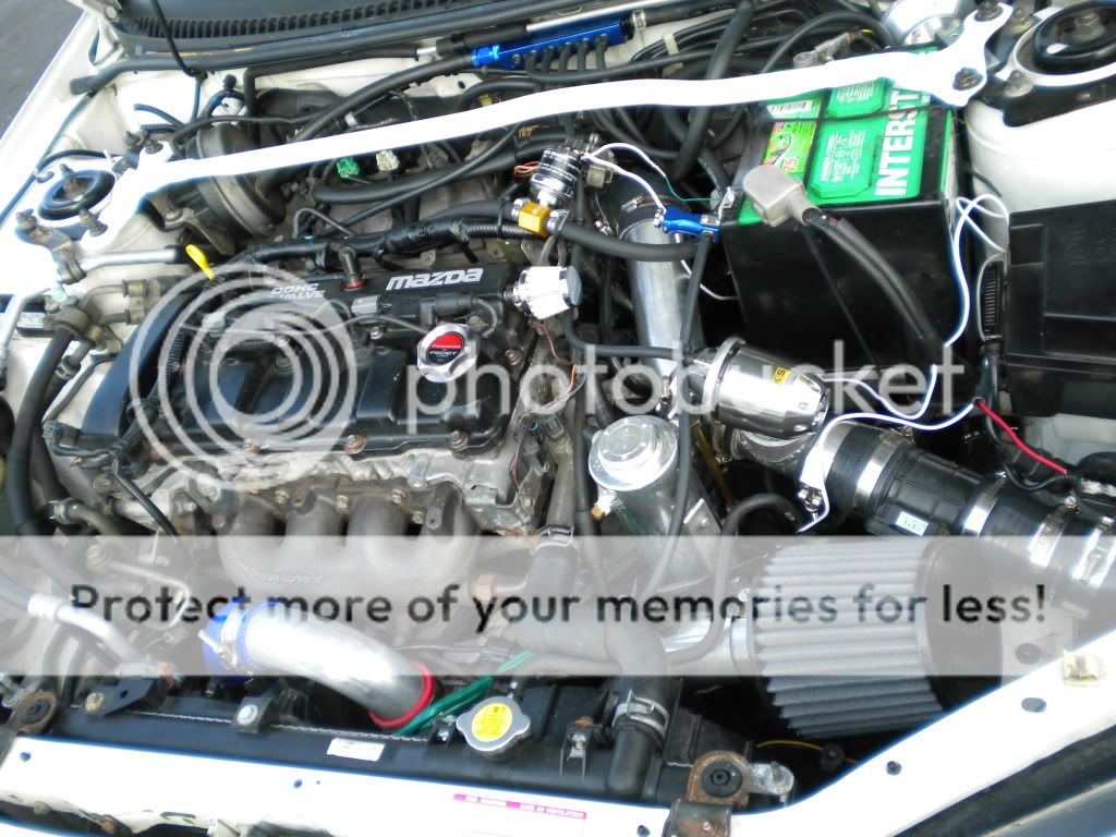

UPDATE 9/25/09 - New Engine Bay Pics
what is your peak fuel pressure at WOT? i am betting a walbro pump will solve this issue of lean spots up top.
I have the fuel pressure sender after the stock FPR so I read the pressure after it. The fuel pressure reads around 80 at WOT and seems to be the reason I'm going lean. You wanna give me a good deal on that fuel pump though Ken? :D
