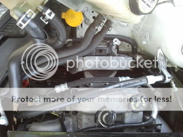

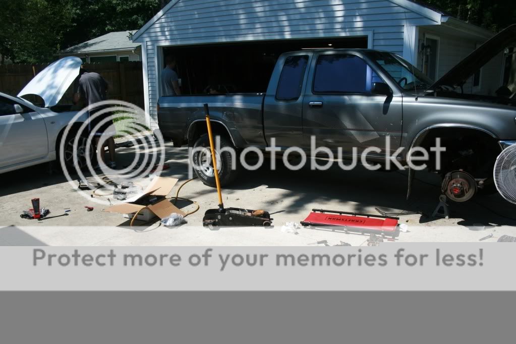

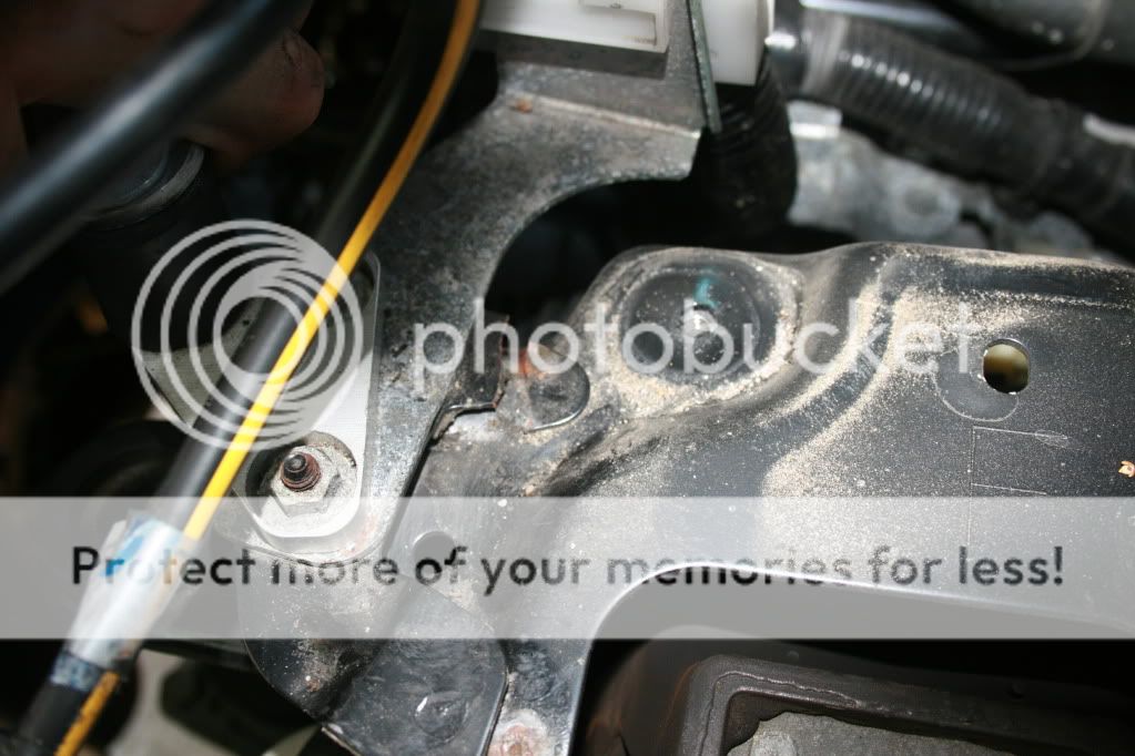

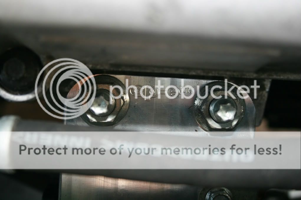

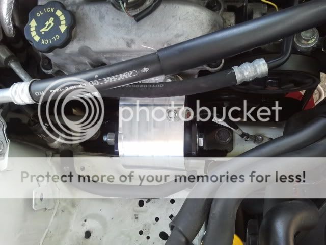

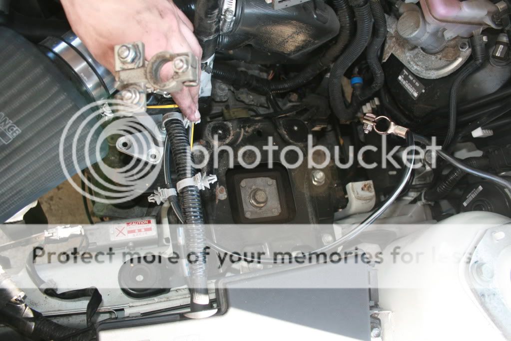

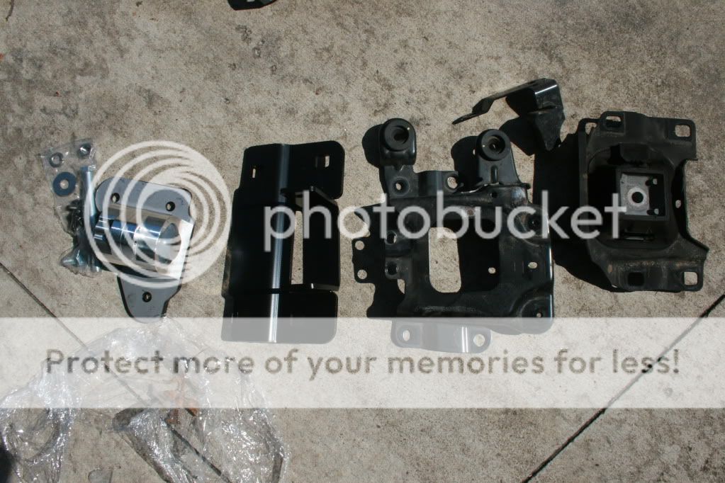

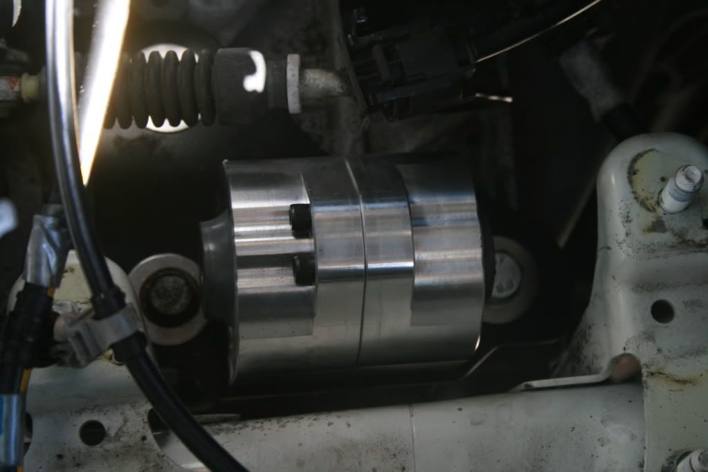

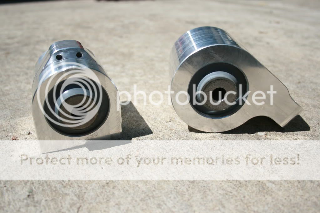

Quick update. Did my motor mounts yesterday. 60 duro CP-e passenger and driver side. The car feels like one piece of metal now. It is absolutely awesome. Shifts feel so much better, vibes are definitely up, and the engine noise is much higher now. The install was really not terrible but it did take me around 4 hours. I had to take stuff off and put it back on a bunch of times but I work very slow. I also installed HID's on my girlfriend's Mazda 6 and changed her oil and filter.

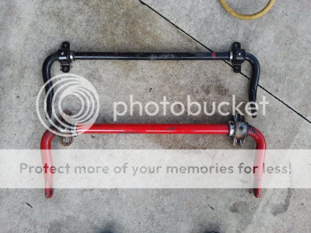

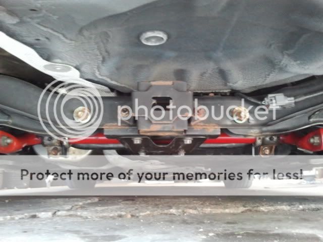

I also installed my new Hotchkis 32mm rear sway bar today. I haven't had the chance to try it out yet to it's full potential but it feels great.

i moto runs a 50mm rear bar on their race Speed 3's!
Holy oversteer Batman!
Those cars must rotate like crazy. Are those bars something they made up themselves or are they available to "Joe Mazda"? I would never need one, I just wondered.
I think that big bar would help them get on the power earlier with the FWD. There's so much understeer in the MS3 when you are powering out of the corner.
They fabricated their own, I'm sure if there was a demand, they would have some available. will is correct, they need to be able to get the power down and you want a FWD to rotate more. If you were auto-xing, you could over inflate the tires to get the car to rotate if you did not have a large rear sway, just a little trick I learned from Randy Pobst.
Over inflation is a good trick. A buddy of mine runs something crazy like 60 PSI in the rear tires of his MS3 to get it to rotate.
