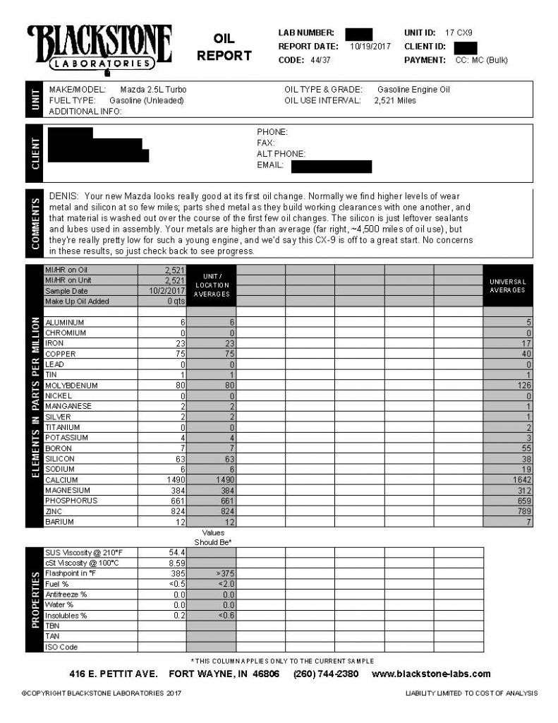

Yes, because the factory fill has very high content of molybdenum.
No it doesnt.
https://www.bobistheoilguy.com/forums/ubbthreads.php/topics/4549396/2017_CX-9_First_UOA_on_Factory
But the High Moly is ONLY the 0W-20 and that was NOT what the factory OEM fill was for the turbo.
Changed at 2k with Mazda moly 0w20, then again at 5k with Idemitsu Zepro 0w20 high moly (supposed to be same as Mazda oil).
Only like to change early to get break-in wear metals out.
