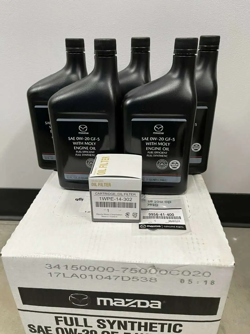

Hi guys,
It's time for the first oil change in my CX-5 2022 N/A.
As always I am going to do it myself, but this is my first Mazda and I am not sure what engine oil should I use...
How good or bad is this one? Do dealers normally change this oil, or they offer something else?
Has someone tried this particular oil and could recommend it?
Thanks in advance!

You have it exactly right. This is what I use (and what Mazda recommends), I purchased a case and two filters just last week. Fortunately for me, both my CX and MX use the same oil and filters.

The Mazda oem w/moly oil 0w20 is one of the best there for the non-turbo CX5s is but it is pricey. If you plan to keep the car for long it may be good option.
Otherwise any decent full syn 0w20 would work.
Dealers dont use this oil for their oil changes. They mostly use bulk oil whatever they get.
My cx5 2018 has been on this oil since new. Never had any issues but I change it every 6mo.
If you are ok with the price, go for it. Its great.
Its a shame such oil does not exist oem for the 5w30 which is for the turbo cx5

Thank you guys for your answers!
Currently, I am choosing between Mazda OEM and Mobil 1.
I agree with Conard 16.5 that the cost is almost the same.
The Mobil 1 at Costco is around 45 bucks plus the filter. The OEM kit is around $65, so the difference is minor.
Two days ago I was confident about using Mobil 1 as all my previous cars were happy with this brand, but then I found out about Mazda's OEM oil, and now my confidence is not that strong anymore...
