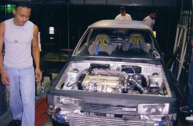

Theres one here in PR running 18psi daily!!!
Its says that the turbo version run 13.5psi stock with 265hp
