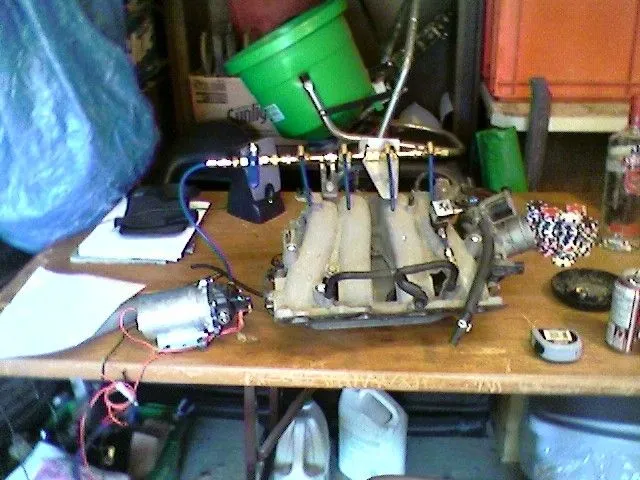

oh and to keep you guys from being totally confused here is your 2nd pic. It is not of the completed system as I dont have a camera. My buddy took this pics a week or so ago when i was still waiting on 3 solenoids and 4 new nozzles.
Everything has been painted black for the Stock appearing look. Nobody has noticed so far :) well gtg hunt down ricers, ttyl. and fyi yes I will be selling a kit eventually.

ok I made 2nd pic an attachment a few posts up, 1st shows up for me I dunno bout u. maybe cardomain is having problems.
pretty sure technical term would be something like individual port digital methenol injection system
and btw dont ever try to tune something like this with a WB02, it cant compensate for the different fuels, you need a Lambda gauge, trust me on this lol!
I am thinking of removing the stock interwarmer in order to keep the turbo in efficiency range a bit more, seems if I am boosting 14psi, the turbo is actually working maybe 16-18psi before the IC restriction. Most people running a system like this in their drag cars are hitting 30+psi without an IC btw.
Direct Port Alcohol/water injection. Nice. How are you going to control it? Let me know what you think of it when you are done.
wow buildup is really beginning now. found a nice bracket to mount fuel rail to the firewall, has nice gromets and everything. Found a guy who sells a very very nice injection controller for only $125 USD. I am currently using an UltraMakeShift controller I rigged together using random boost sensors, resistors and a couple other random bits to control the system all mounted in a old HP small form factor case lol, the new one is much nicer and is accurate to whithin 0.2psi. Waiting on 4 new 0.7 nozzles, the ones I have are too large for my application.
