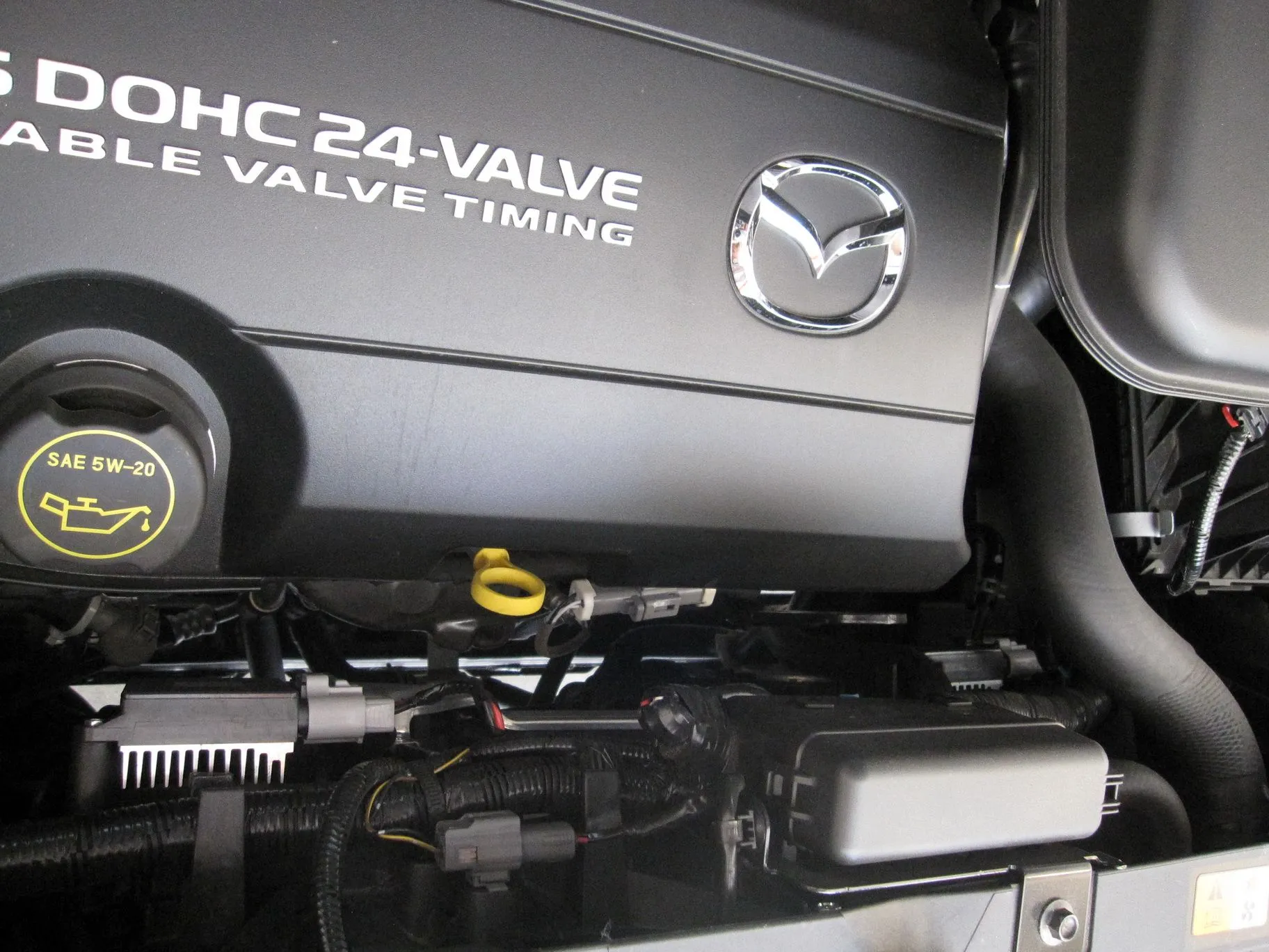

To tell if you have the extra cooling, look at the two radiator fans. If they both have the silver control module on the fan frame, like in vike's center photo, you have it. Non towing like mine only has one on the drivers side fan.

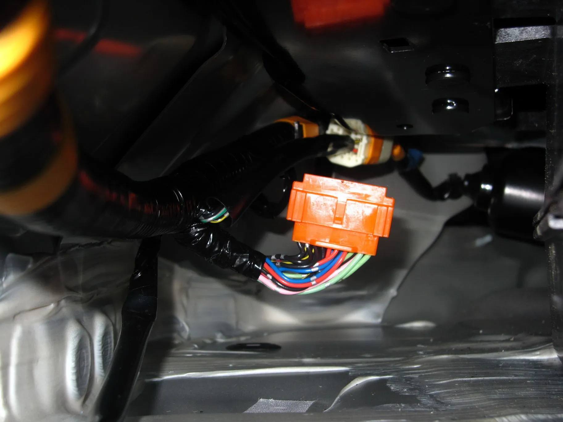

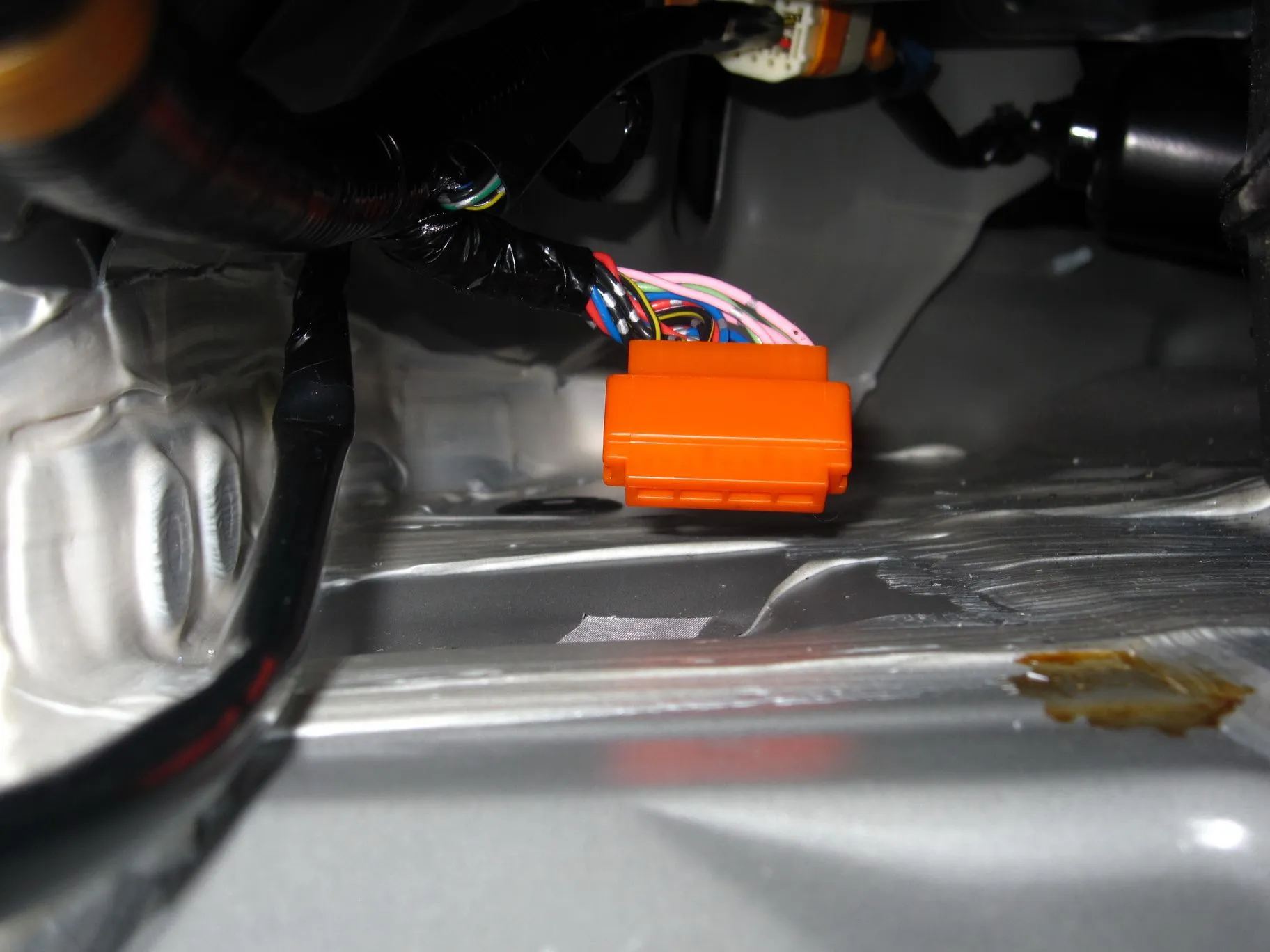

Yes I am in Canada, here's the picture of my CX-9 I took few days ago.

Does anyone has a page of workshop manual showing the wiring for the hitch signaling/light? Can you please post it here. Thanks.
You have the heavy duty cooling. Just need to add the receiver and harness.
There should be a connector under the left rear cargo bin. Otherwise, you just have to tap the lights yourself, which is really all the factory plug does, and run power to the battery.
A awl type 12v test light works well to ID the wires, if you don't get a schematic from anyone.
On the left rear cargo bin of my CX-9 there's a Bose subwoofer, when I open the compartment for the jack and look thru I can see a white connector I don't know if that's what you are pertaining here. Is there a way I can remove the cover of the subwoofer without damaging it or voiding the warranty?

If it's a square connector not hooked up, that's probably the one the trailer converter will connect to. Use a test light to conform brakes and turn signals on it. I honestly don't know how the subwoofer comes out. Maybe someone with the Bose can help on that. Probably not much to it. The connector, and a couple of retainers, I'd guess.
The CX9 does have standard transmission cooling. The tow package just changes the fan control modules to keep more air across the radiator sooner.
Also, take the rear cargo bins out and see if the trailer light connector is there. It taps into the left side taillight harness, I believe, and will be a square connector.
If this is the way to tell (truly) then my CX9 AWD GT without towing has the heavy duty cooling. I have two fan controls, one on each fan with heatsink.
The controls are black the heatsink is silver (aluminum)

All 2009 GT AWD has the Tow Prep included as standard.
Therefore, it is no surprise that you have dual fan control modules.
Tow Prep has everything a Tow package (of 2007-8) has excluding the hitch.

Is this the connector for the hitch wiring? This connector is located near the Bose subwoofer left side bumper.

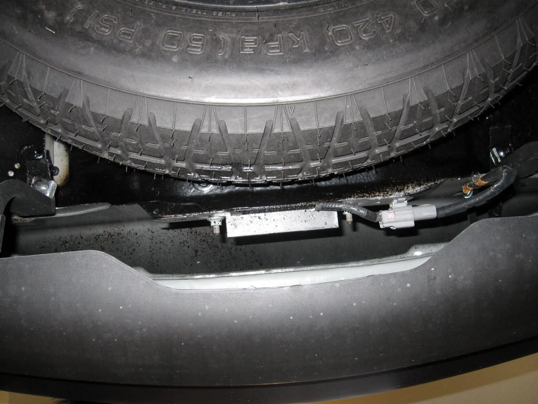

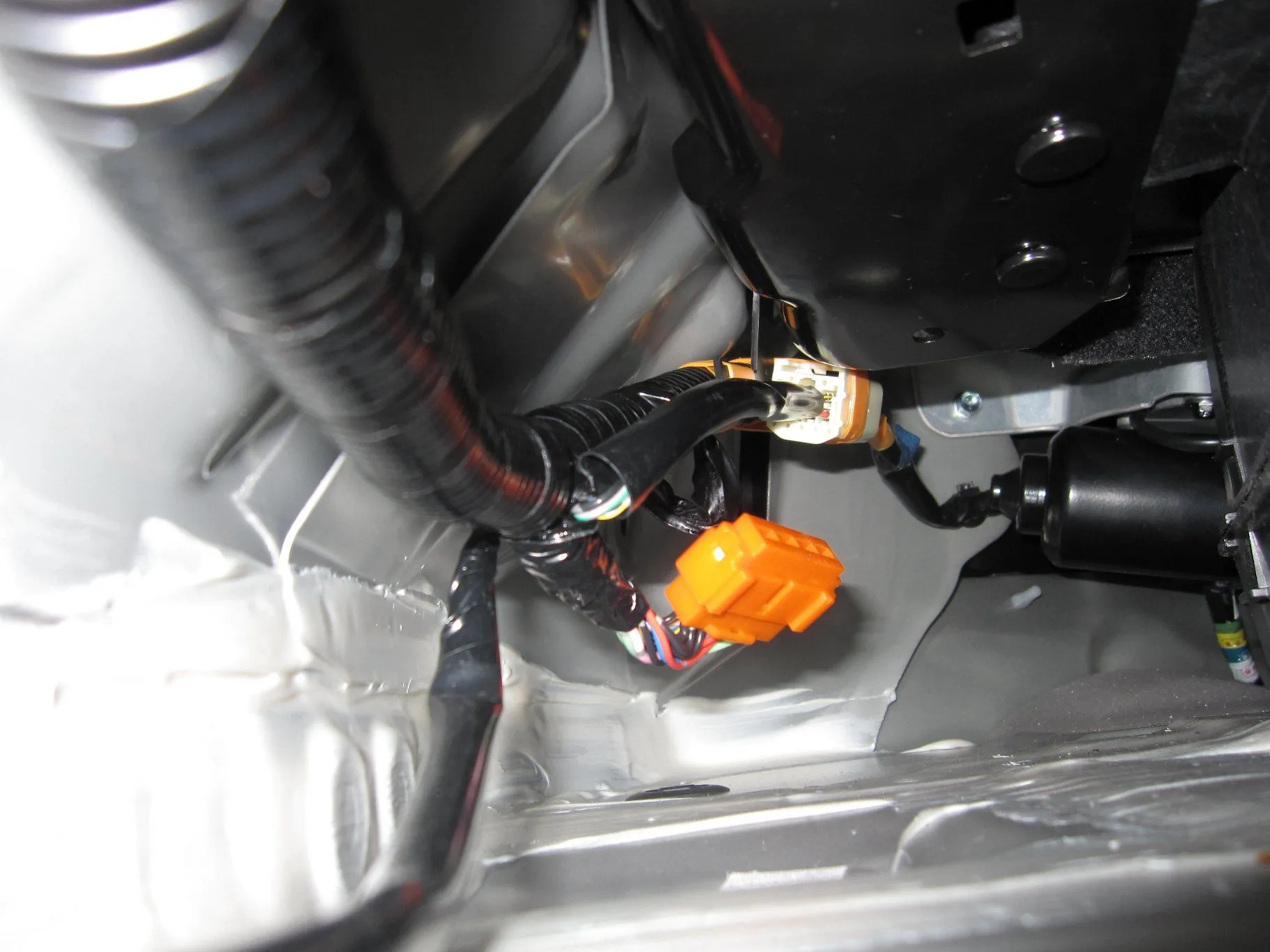

Are there any CX-9 owners with towing package on their 08 can you please take a picture of the OEM hitch wiring connector, located in the left side tail of the car under the cargo bin? I want to confirm why the connector just like the one I posted here got so many wires, please see the attached pictures. Is this the correct connector for hitch wiring? Why it got so many wires?
