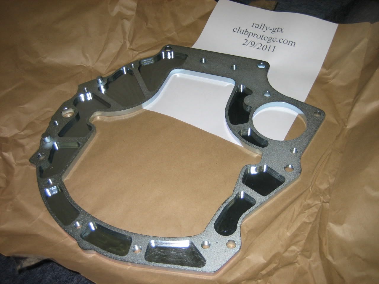

for anyone who wants an adaptor, the guy to harass is "rally-gtx" on clubprotege.com
he makes a lightweight version too. below is the bp/e153 version. I dont know if he has any FE3 / FSDE plates made, but Im sure if you asked enough and got some people interested in a GB he would make more
