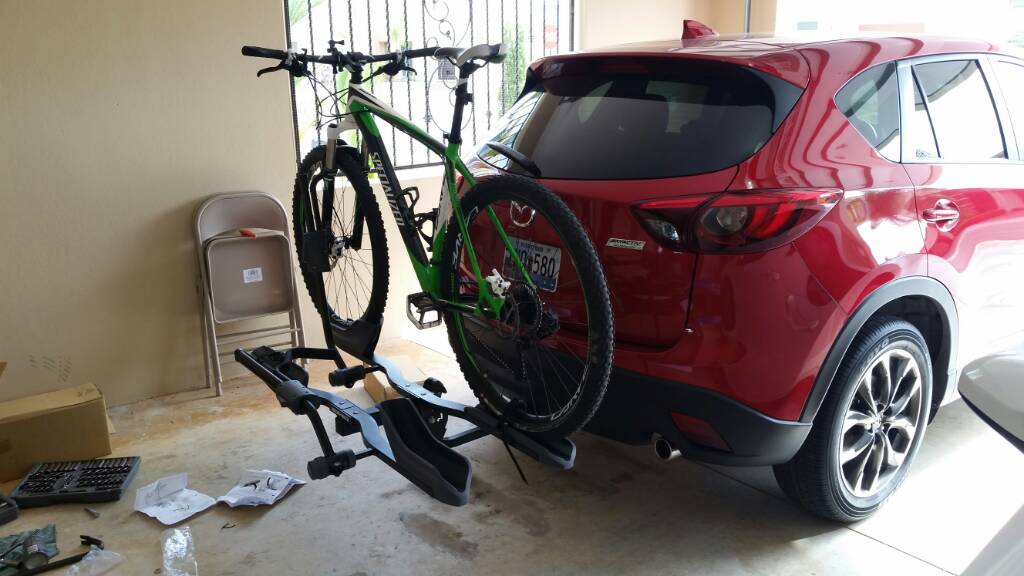

I have roof rails on my CX5 and don't have a clue about Kayaks, but I was sure that I did not want a roof rack for my bikes for several reasons. For bike hitch mounted racks there are a lot of choices and price ranges. Cycling is a huge part of my life so the quality was really important. I ended up with one of the most expensive racks on the market, but it was well worth it to me. The two most respected racks on the market are Kuat and 1UP, but there are many racks that are decent just below those two. My other preference is a rack with a wheel tray rather than a top tube mount where the bike is dangling or has to be secured by a multitude of bungee cords. All of those things are preference things that each of us have to consider the value.
You can see the rack I use on my blog using the link in my signature. I really like the rack and the bike travels well on long trips without any hitch movement.
That Kuat rack seems very nice. I worked in the bicycle industry for 8 years in three different states and have never heard of them. The fact that it has a maintence stand built in is very cool. I'm mostly familiar with thule and Yakima racks.
Thank you felt rider. I looked at your pictures, and it does not look like they needed to modify the bumper at all, correct?

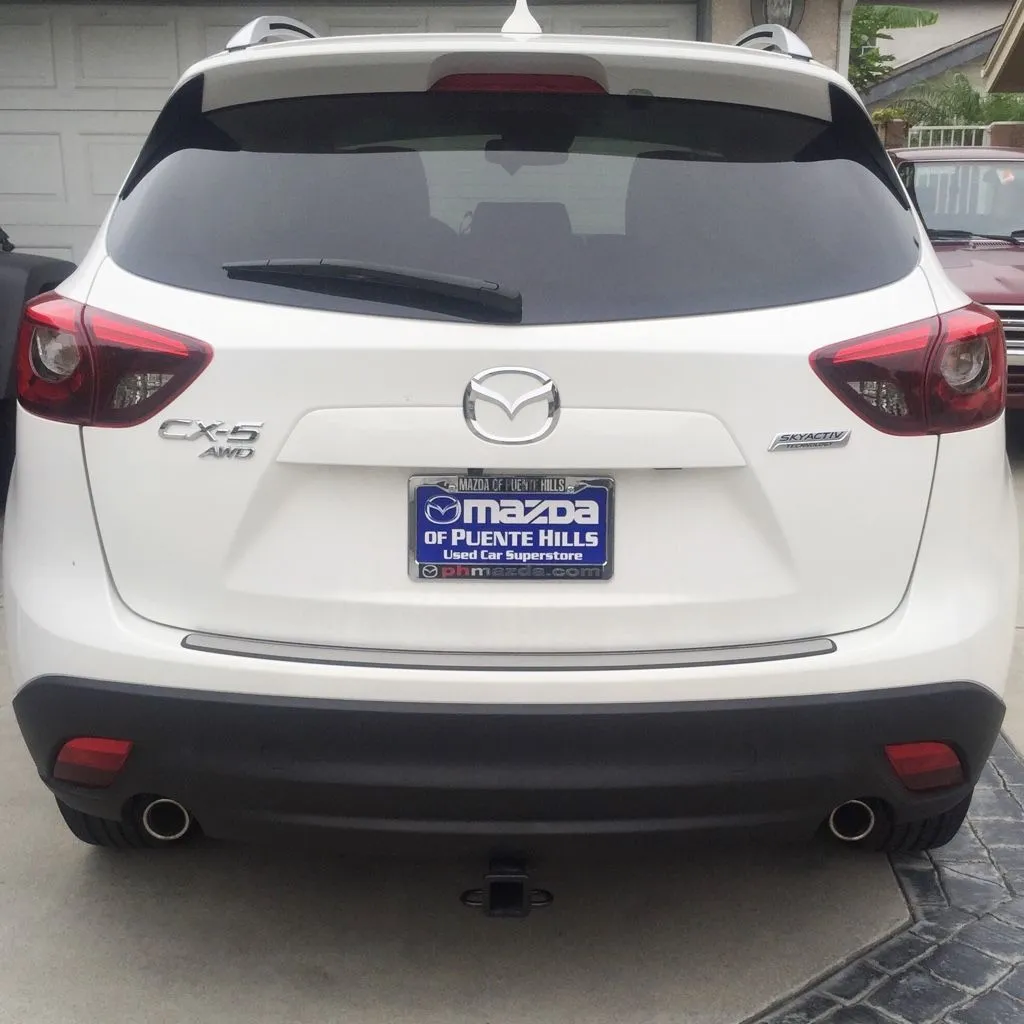

I have that one. The etrailer install video helped a lot. My boyfriend and I installed it within 20 min. We did it step by step exactly like the video. And I love that it's low profile. ImageUploadedByTapatalk1437784746.586501.jpg
