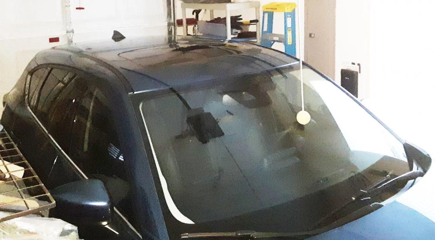

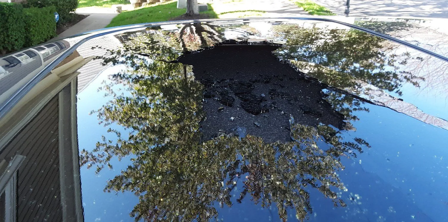

For the curious, I have attached two images of the "exploded" sun roof. The picture taken outdoors has a lot of reflected sky and a nearby tree in it, but the hole can still be easily identified. The picture in our garage may show the hole more clearly.

I have been in frequent communication with both my local dealer and Mazda USA. Neither acknowledges any responsibility for the damaged sunroof and neither is willing to cover the repair costs. My car had 1,992 miles on it, and was only 3 months old, when the sunroof failed.
