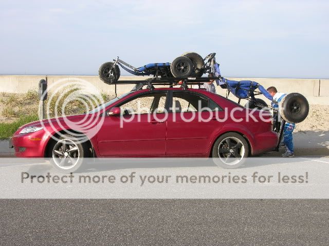

This is what we haul on the 05. It's been a wonderful car and a great piece of transportation. Maybe I ask too much from it :(
