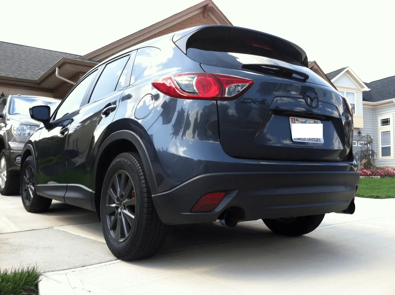

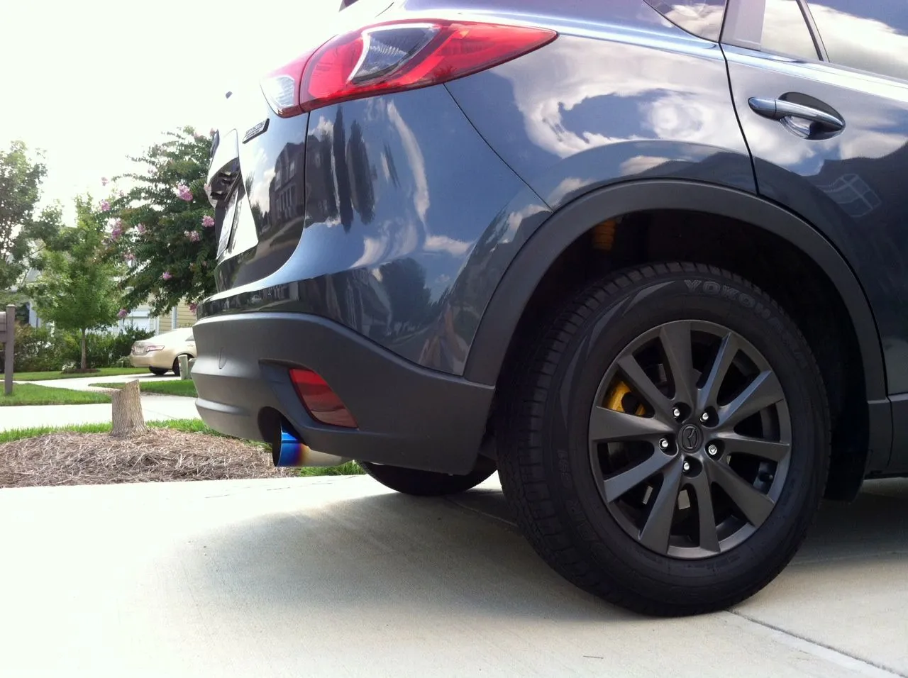

What about this one:
That looks like a longer version of the 6.5" Magnaflow tip I used on mine (see post #280 on this page http://www.mazdas247.com/forum/showthread.php?123826557-What-Did-You-Do-for-Your-CX-5-Today/page19) At 9" you're going to be too far back into the tailpipe curvature (unless you plan on reconfiguring the curvature of each pipe or having the outlet stick out about 2" beyond the bumper valance. Also, just realized the one you show is 3.5" at the outlet. Mine is 4" which fills the bumper cutout better.

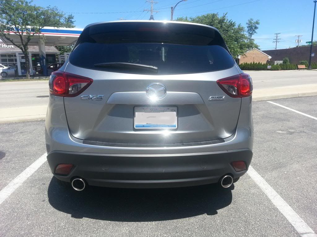

Hey all! After seeing some great pics, I did exhaust tips as well. I measured and the stock tips were 3" in outer diameter, and I found these on https://www.amazon.com (commissions earned) and I hoped they would fit. They slid easily over the existing tips with very little play. I took them to a muffler store and for $17.80, had them welded on. Because of the angle cut to them, I decided to have them welded on, turning the top 90 degrees inward and with the inside edge just flush with the edge of the bumper. Since the angle of the cut and the bumper didn't match, this left some chrome exposed, but I liked that better than recessing them further. Since this also left the drain hole exposed on (and now on the side), I put in tiny chrome plugs from the hardware store. When the car was cool (and going to sit overnight) I brushed the edge of the old tips black with flat bbq paint, so they would not stand out as much when looking in.
Overall, I'm really happy. Thanks for the inspiration!
Atomic: I went through the same thing with the BBQ paint, 'cept I used Hi-temp header paint. The guy who welded mine on left one inner pipe slightly longer than the other and it drove me nuts looking into them from the back and being able to see the difference. So I caulked the raw edge inside and shot it with flat black paint and the problem disappeared. Crazy the lengths some of us go to for "perfection".
paris1: I love your tips! You and felixd's pics are what pushed me over the edge. My 20 month old son has a mild underbite, so I tease that Daddy will never get his Corvette, so I am going to "trick" out the Mazda. :) I went back in the shop and supervised the welding and positioning because I was so paranoid about it. Loved the positioning, and hated seeing the inner pipe, so drove straight to Menard's to get the bbq (hi temp) paint.
I really do think it fills out the back end well.
paris1: I love your tips! You and felixd's pics are what pushed me over the edge. My 20 month old son has a mild underbite, so I tease that Daddy will never get his Corvette, so I am going to "trick" out the Mazda. :) I went back in the shop and supervised the welding and positioning because I was so paranoid about it. Loved the positioning, and hated seeing the inner pipe, so drove straight to Menard's to get the bbq (hi temp) paint. I really do think it fills out the back end well.
I supervised the welding on mine too. It was tough getting everything lined up just right and the guy made a cut that I really wish he had not, which caused the uneven length of the inner pipes. Oh well, sometimes you just gotta settle for 95% perfect!

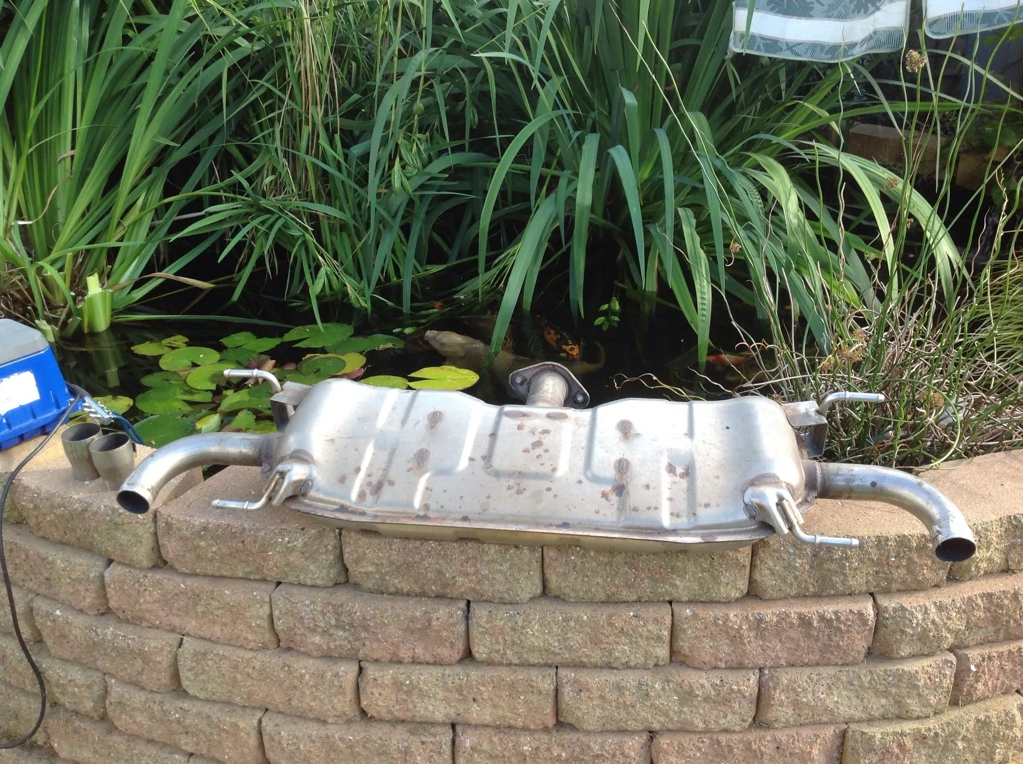

I bought a second hand rear exhaust box and cut of the cheap and nasty chrome ends ready to weld some top quality megaflow tips
I'm also looking around for a second hand muffler-but I'm going to try something different.
I plan to cut it open and have a look inside-I'm thinking about removing some of the "baffle's" inside,then weld back up, refit and see what it sounds like.
Might be crap, might be too much drone-but nothing to loose,as it will be a second hand muffler.
