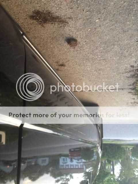

Started my door molding delete today. Got most of the adhesive off of the doors, pics up tomorrow.
Awesome i wanna see how they turn out. i was thinking of doing these too but i was scared if there are going to be some holes at the end lol. post pics soon man. ohh and by the way Jason Naoto told me you was at the show. was looking forward to meeting you but you left after it rained hard he told me lol
I like the cleaner look. So far just the adhesive is sticking to the doors, and since its white adhesive, it looks like crap. I have the passenger side mostly done. I was worried about holes too, but there are none. I saw Naoto's car and it looks awesome. I'm jealous haha. I looked for your car and was hoping you'd be there but I had looked at all of the show cars by the time it started to rain and I decided to leave. How far away are you form vab?

NNOOOOOO! get 3M adhesive remover. it'll save you at least an hour of work. spray on, let it sit for 5 min, wipe off, done.
I looked for it! I couldn't find it in any of the stores so I had to go with goof off. It didn't work well so I'm doing the soap and razor trick and it sucks deluxe.
A pin stripe remover on a drill works pretty well for that sort of thing. It's pretty much a magic eraser and you should be able to get one at any auto body/parts store.
Looks like this and you won't risk messing up your paint.
