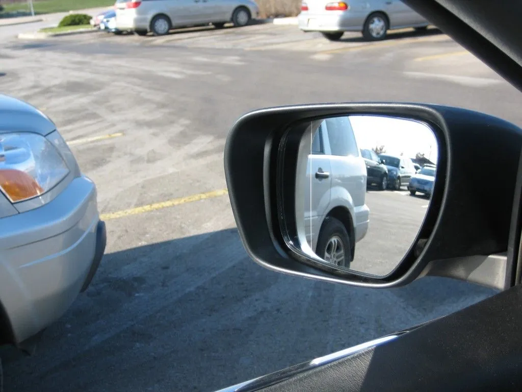

European mirror installed, no more blindspot
OMF, are both of the mirrors convex or just the driver side? In the pic, it seems like only one mirror is convex. What's the point to get the other side if it is the same as OEM?
Also, will this take care of the crappy vibration that the OEM mirror has? I am not sure if it is the mirror itself causes the vibration or the housing.....thanks
Sounds like the EU mirror will be a preferred option for the 2007 owners only.
The attached video clip View attachment 120456 will help you understand what can you expect from the blindspot-free mirror.
Left and right mirror plates:
Both of them are convex, the passenger side is also better than the OEM.
I read about the vibration issues, but I haven't had that problem even with the OEM mirrors. Filling the three mounting pins with thick, white grease could probably help.

in Australia the CX9 does come with a convex mirror on the passenger side, driver side is not convex. The idea being that the blind spot on the passenger side is the more problematic for a driver. Its a bit different from the euro one in that there is no visible line between convex and non convex areas. However the is one problem for you guys in USA. Our passenger side is left side of car (as we drive on left side of road here). I don't think there is a right side convex mirror available here.
in Australia the CX9 does come with a convex mirror on the passenger side, .... Our passenger side is left side of car (as we drive on left side of road here).
Since the North American version comes with a flat mirror on the left hand (driver) side the Aussie left (passenger) side convex plate is that they would need. (headbang)
The US right (passenger) side is not a big issue, because it's slighly convex.
Are your mirrors heated? If so, I guess you will get a several requests in the near future to ship the mirrors to the US....
on the Aussie luxury model mirrors are heated. Our left side isn't hugely convex...so it sounds very similar to your right side.
