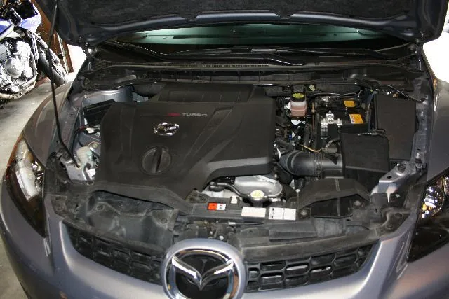

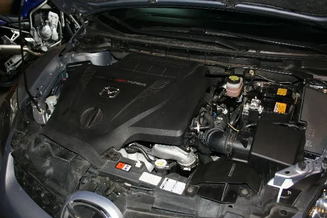

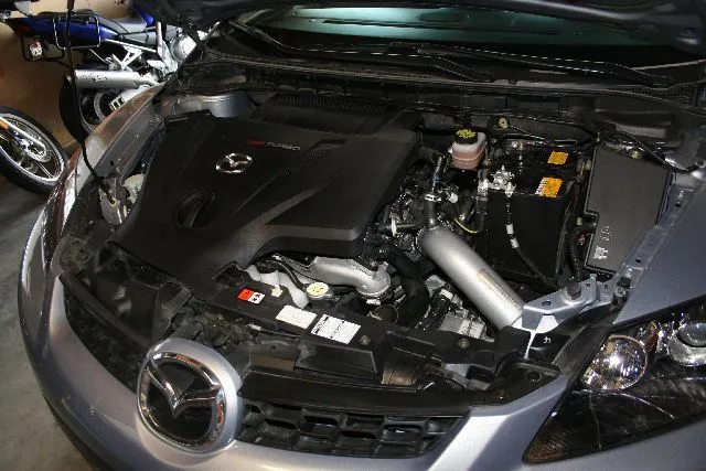

Anyone have pics of the ETS with the plastic shroud installed?
I'm wondering how under the radar the ETS is after everything has beed installed over it?
Here are some pictures of it with the stock intake and the CPE intake

Alpha Wolf,
The CPE intake goes through the fender well doesn't it? What happens in the rain or snow or extremely dirty road conditions without pavement? It sounds like a good way to get cold air but how often does the filter need to be cleaned? Can you remove the filter without taking off the tire? Did you get the prefilter also? Sorry for so many questions but I am very interested in this mod.
Thanks,
Gary
The filter is actually better protected in the fender than it would be in the engine compartment. It's pretty much surrounded by the frame, bumper and fender lining. My piping has more dirt on it than the filter!
You can pull the filter (and install the CAI for that matter), without pulling the tire off. You just need to turn the steering wheel all the way to the left and pull the fender lining.

Alpha Wolf,
Thanks,
Gary
Hi Gary,
As super stretch stated above. It is off into the fender which has only one opening to it that is via the engine bay where the piping goes in above the frame. So dust dirt rain etc are not an issue. If you wade through 3 ft deep water you may have an issue.
I have the pre filter on it and so for it has not needed cleaning.
Then use K&N release and blow it out with compressed air.
Yes you can remove the filter by dropping the fender liner, turning the tire and reaching in.
The only downside is having my wife make faces when it boosts! She calls it flushing! (pissed)
I love it..(nana)
Here it is.
Some have installed the 3.25" ones without issue.
