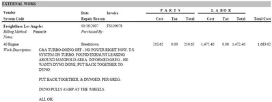

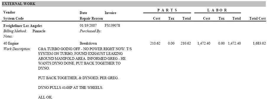

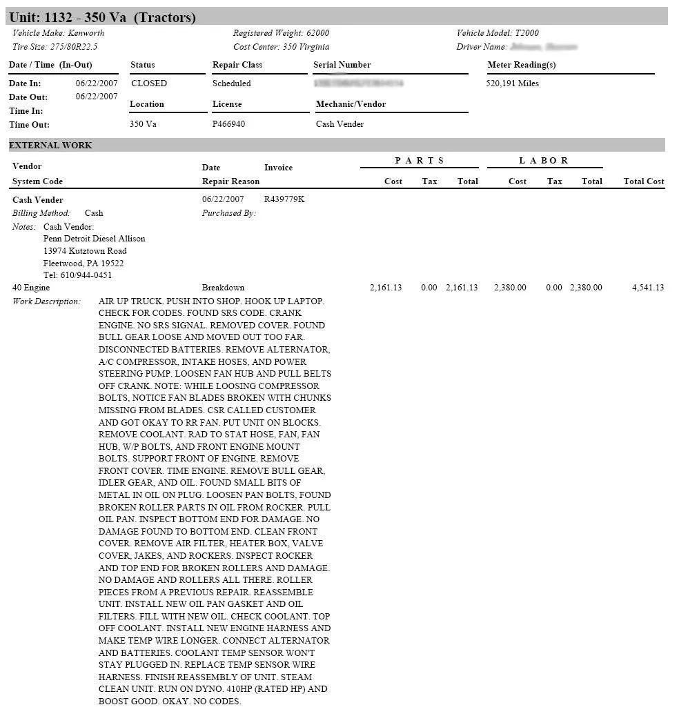

Okay, about three years ago we did a comparative test between the last of the KW's to carry the Series 60 engine before Mr. Penskee bought Detroit and they became Freightliner-exclusive. We lined up a brand new T-2 and Columbia same engine and did a series of tests (dyno included) between the two (air cooler color was not something on my mind at the time lol).
I can't find that paperwork. Sadly.
What I did come up with are some copies of service paperwork within the last year of vendors running our units on dynos. The two examples I'm providing are vendors performing dyno runs on one Freightliner and one Kenworth T-2000 with 550,000 miles on each of them. Both were recently serviced (within a month). Both are equipped with the same gearset, trans (Eaton-Fuller 10sp Lightning Top-2) and diff. Both with the same ECU parameters; running 22.5psi boost.
We deem 15% power variation to be within the norm. These are two of our more meticulously maintained units, however, and when they went into the shop for power loss we decided it was best to have them tested on the dynos.
The Kenworth, with it's black charge air cooler, runs 410hp at the wheels and the Freightliner, with the aluminum, runs 414hp. The KW was done at a Detroit dealer and the Freightliner at a Freightliner dealer. A 4HP deviation is remarkably small considering the multitude of things that can affect a truck's power level. I did pick these two examples, in particular, because of their similar attributes, however, with the number of other things that could affect the power rating, it is close enough that I would say the HP ratings are "the same".
Lastly, when we ran our test, every temperature we could come up with, related to the turbo, ran within 5 degrees of each other, throughout the duration of the test. The tests were computer controlled with self logging ACER sensors.
Given this information, I think the biggest thing left to figure out is whether the IC being front mount instead of top makes a big difference.
