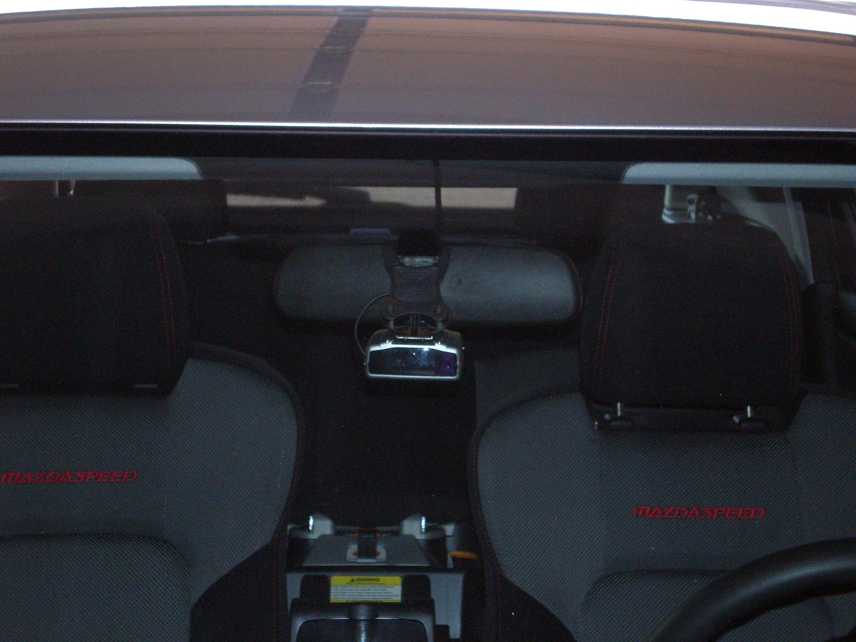

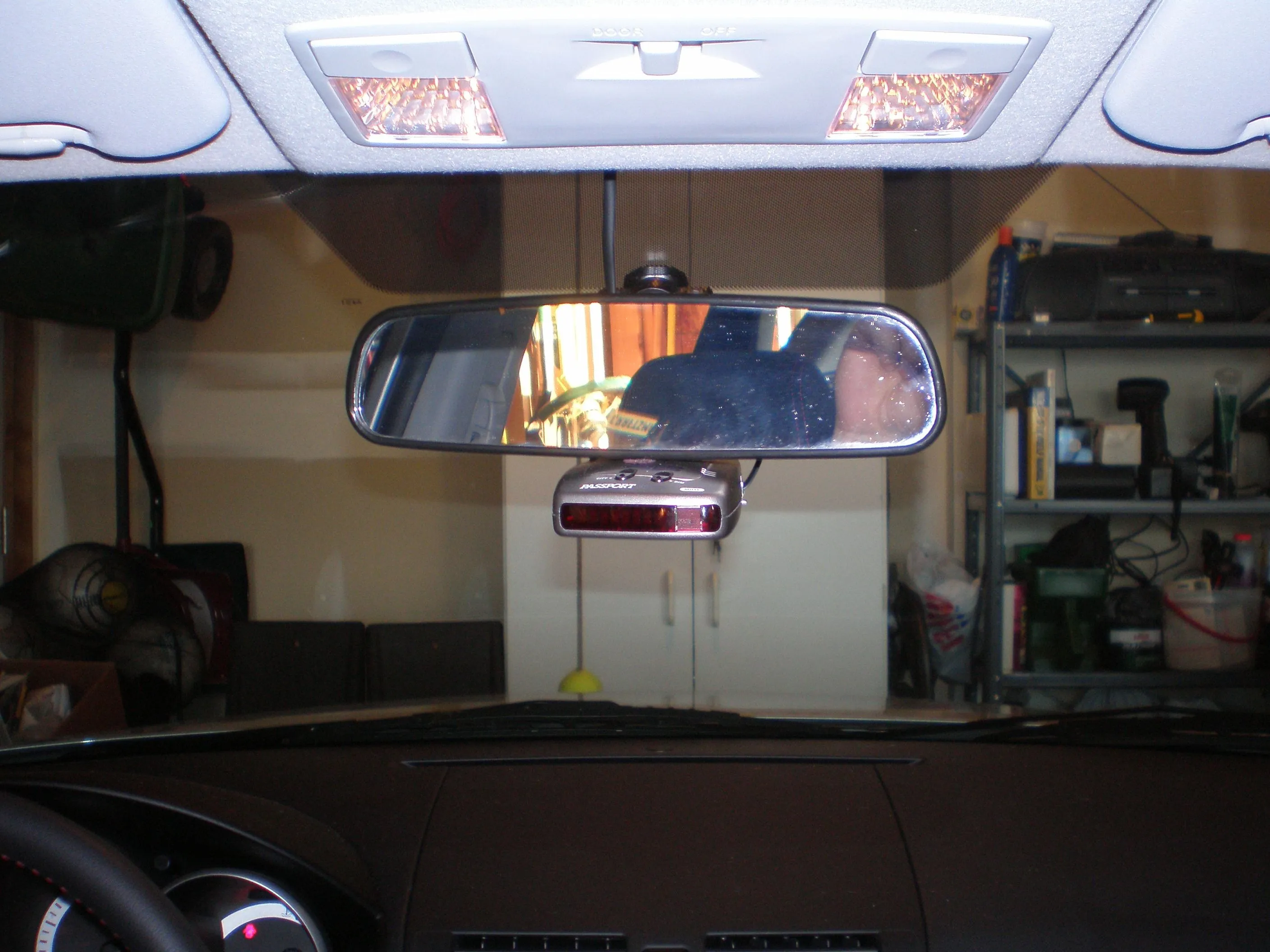

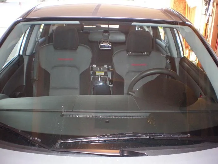

Here are a couple pics of the finished product. I am kicking myself for not taking photos while I was doing it.

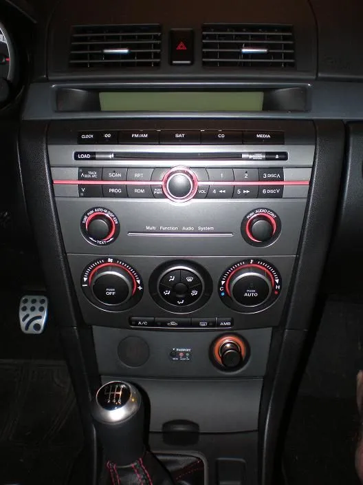

This list looks like it is a tough project, but I custom mounted the Smartcord in the section of the center console between the cigarette lighter and the airbag light.

  7. Remove Cigarette lighter/Airbag light panel from center console. This takes patience and persistence. You have to pull on it just right for the tabs to unlock.
  8. Decide if you are going to try to use the SmartCord functions or just hardwire it for power. If you want to mount it like iI have, break out the dremel and get creative. In a nutshell, drilled a couple holes in the panel for the LEDs. Then I hacked apart the case of the smartcord button and LEDs with the dremel. Used the epoxy to adhere the hacked case to the backside of the panel. Then I glued the sticker for the smartcord onto the panel over the holes.

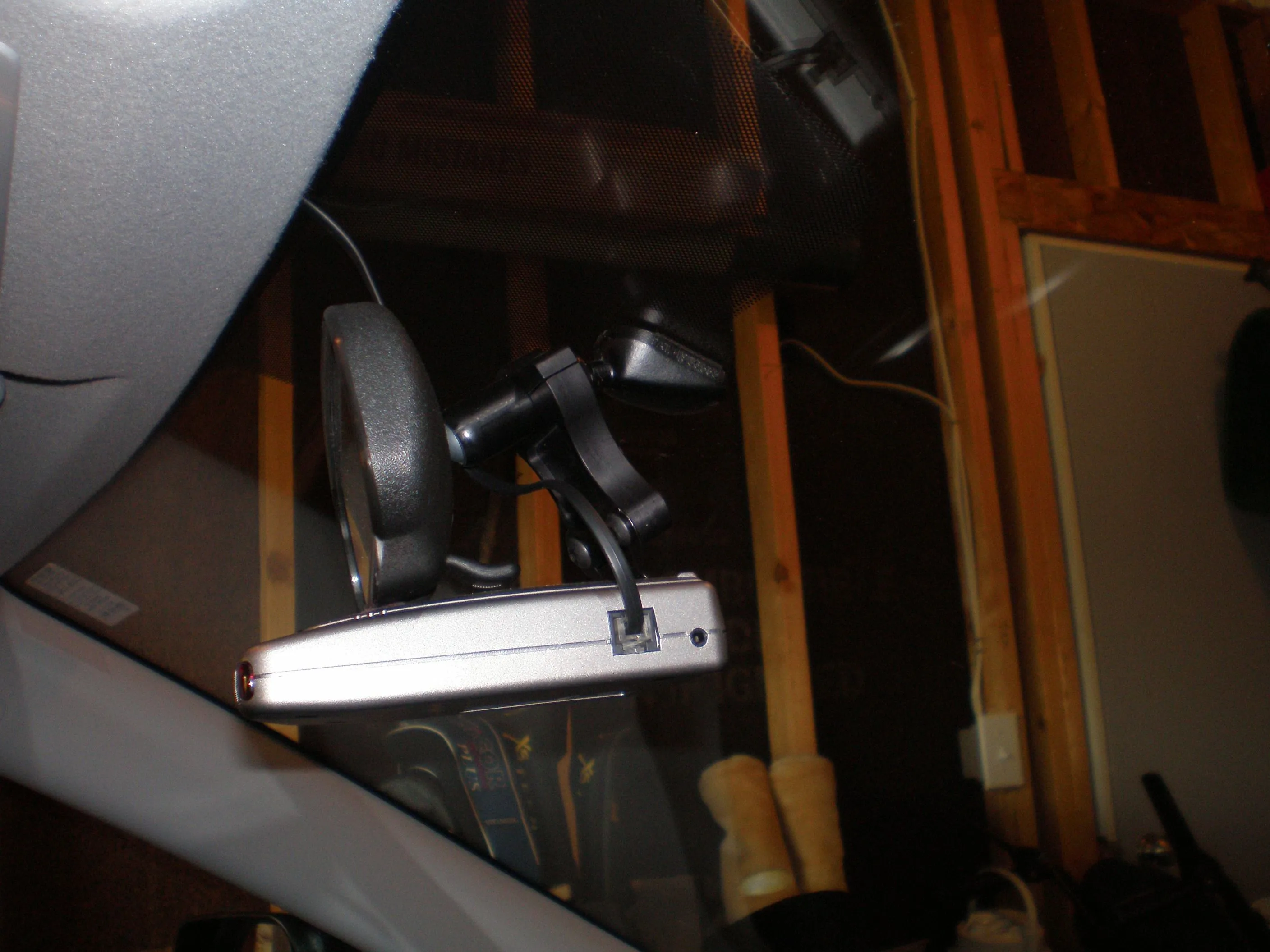

  18. Install the mounting bracket for the escort.
  19. Attach Escort and plug in the telephone wire end of the hardwire kit.

Here is the final product.
