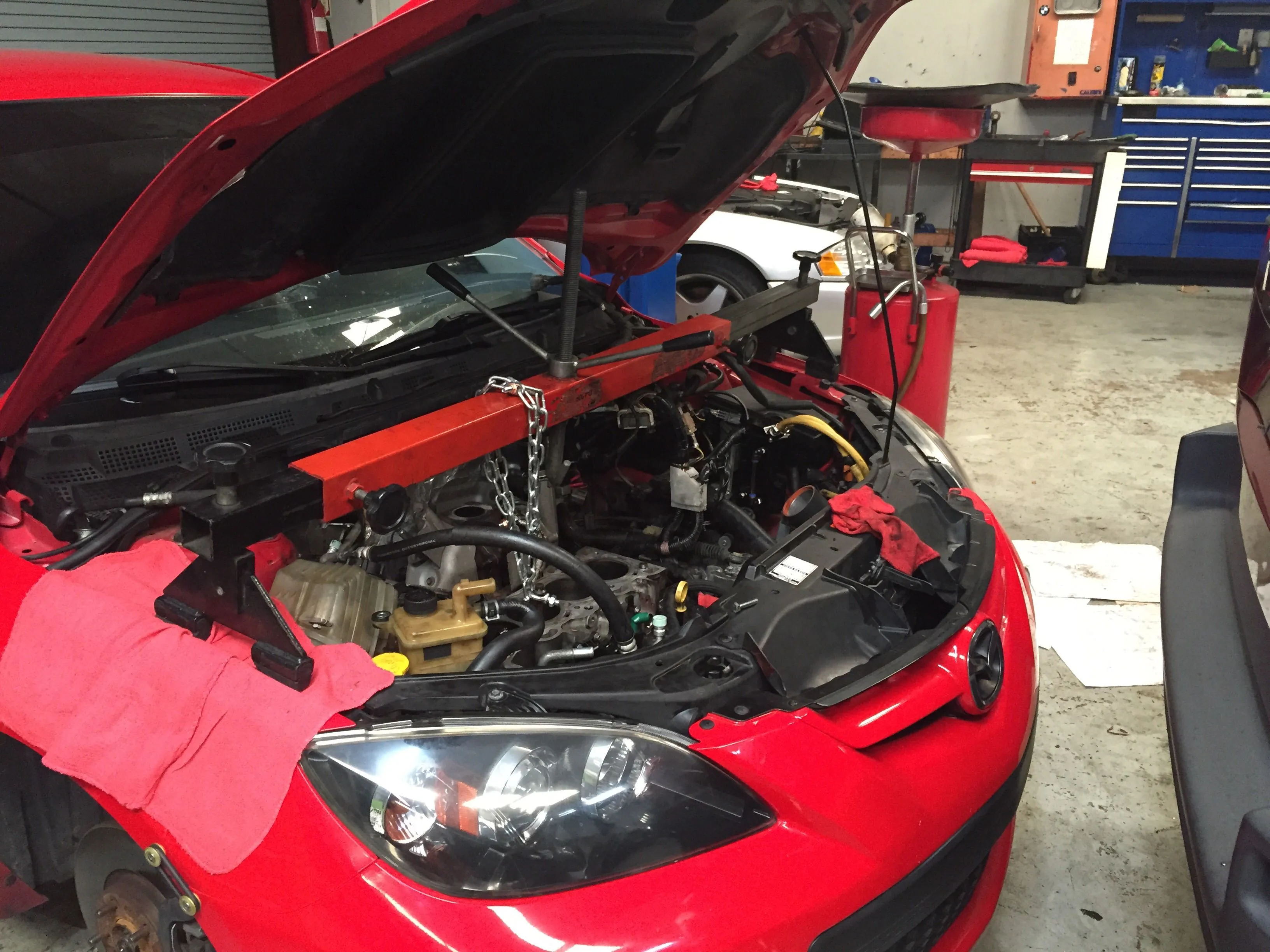

good evening everyone, ok so I've been a mechanic for 4 or 5 years now but I have a couple of questions on rebuilding my engine. First off all I was just cruising along (-10 on the boost gauge) when I had a massive turbo surge (how? idk...) and Fuel cut at 55 or 60 mph and it fell on its face hard..... REALLY FU*KING HARD and there was a very loud consistent tick from the head or block. Well when I got it ripped apart there were two veins from the turbo missing. So I was like.... Huh... I then proceeded to pull the head off my block and to my surprise... There are no bent valves, no turbo veins, all of the cam lifters are in the green zone and are not out of adjustment. Hmmmm wrist pins?.... Let's check. Nope four bent rods.
