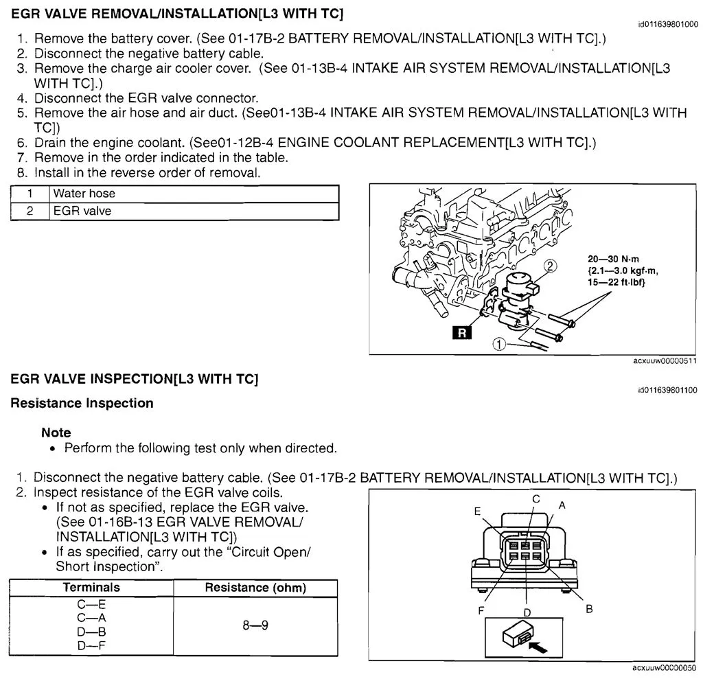

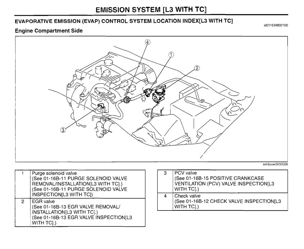

Here's the location of the EGR valve.
thats such a big help dude thanks for the diagram. where did you find that?

The swap is not hard, just time consuming.
You need to remove the battery and its box, then take out the turbo inlet.
The EGR valve is more or less behind that.
Don't forget to drain your coolant first. There is a coolant jacket in the EGR valve. It'll get messy otherwise.
