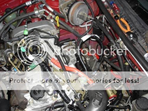

Can anyone give me any advice for getting the EGR pipe nut off the exhaust mani or intake mani side? The exhaust mani nut seems to be at a less ridiculous angle, but it isnt budging, even with some PB blast and some mild tapping.
the exhaust mani side i just used a large adjjustable wrench. the intake side i heard is a biatch
The only way I've found to reach the Intake Manifold side is to remove the intake, and throttle body....It's a b****, but probably takes less time than screwing around and trying to wrestle your way in there....I'm not touching my EGR until I'm swapping my IM....Not worth the hassle until then...

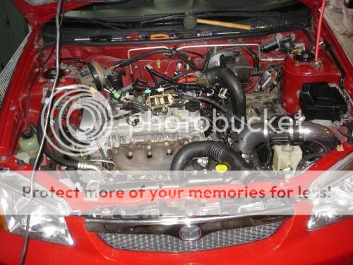

I ended up just taking off the throttle body, but it's still nearly impossible to get a good grip on the IM side. So, I guess I'll try the mini torch. Did I mention that I absolutely hate seized bolts and nuts?

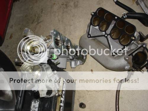

Would anyone want for me to piece together a how-to writeup for complete IM removal and reinstallation?
Sucess at last!
yeah isn't our intake manifold fun to get out? I had a TON of fun replacing the bolts that support the underside of the intake manifold, bracing it against the block.
For anyone that's taking their IM out in the future, a HUGELY helpful hint is to loosen the EGR pipe fitting at the intake manifold first with a 27mm non-adjustable wrench (preferably a flare nut, when your IM is ready to be removed) then take the runner half of the IM off the lower plenum so that all your left with is the lower plenum + the EGR pipe in the engine bay. Having only the lower half makes it infinately easier to navigate the IM out of the engine bay with the EGR pipe intact.
