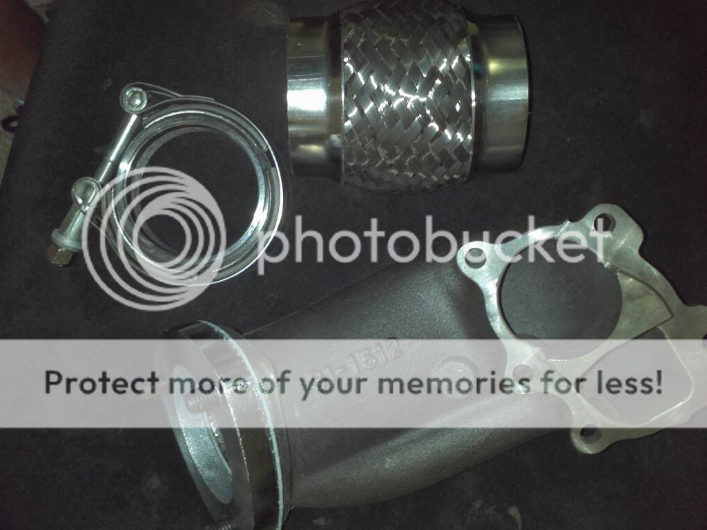

ill try to get this done as soon as i can hopefully before new years.

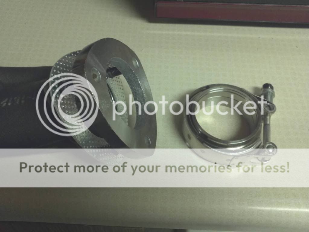

two of my flanges came in today just waiting on the flex pipe.
as you can see in the pick going to have to drill some holes bigger
Are you going to put the flex pipe right off the flange? I'd use an elbow to get the flange to the flex pipe as perpendicular to the ground as possible, then put the flex pipe between the elbow and the mid pipe. That would give the engine and the exhaust the greatest range of motion from each other.
Take lots of pics as this thing gets fabbed up.
well i got the flex pipe in went to the Muffler guy to see what he had for pipe bends he only has straights but will bend me one. Im not a fan of the bent pipe becuase it leaves a pinch so im just going to buy a 40 guage 90 buttweld for a better curve.

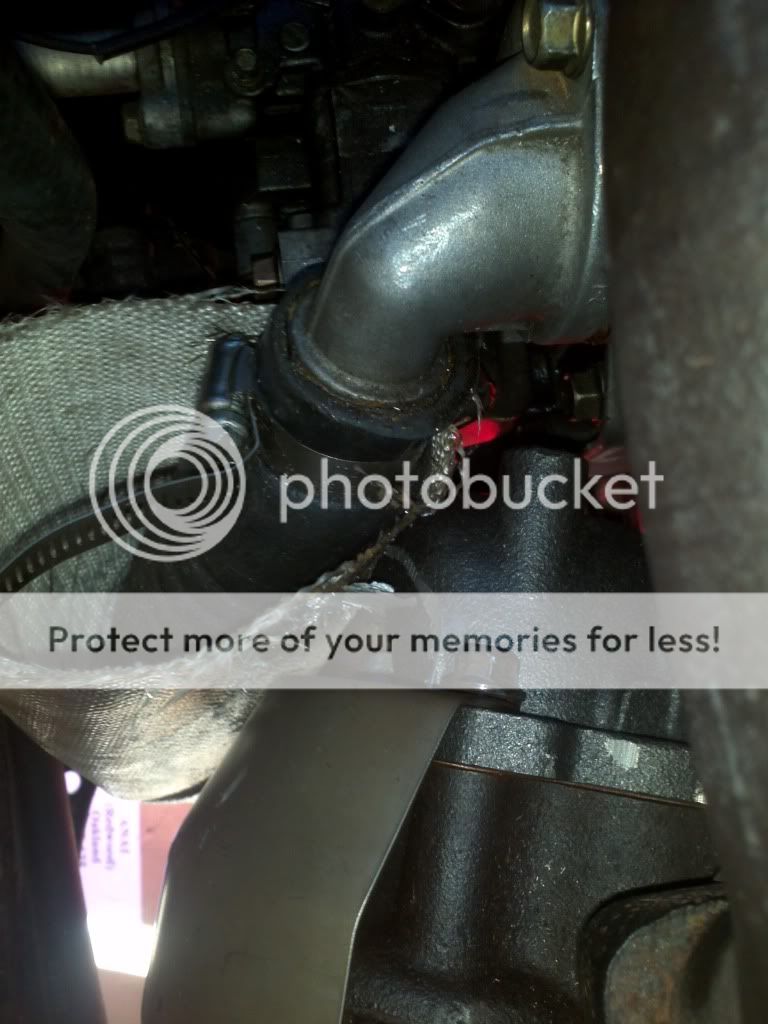

I really wana see it fitted to the car. It looks so close in size to mine I might not have to have anything done

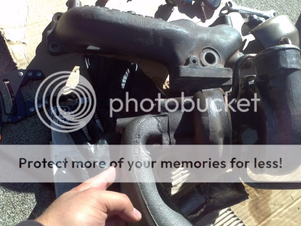

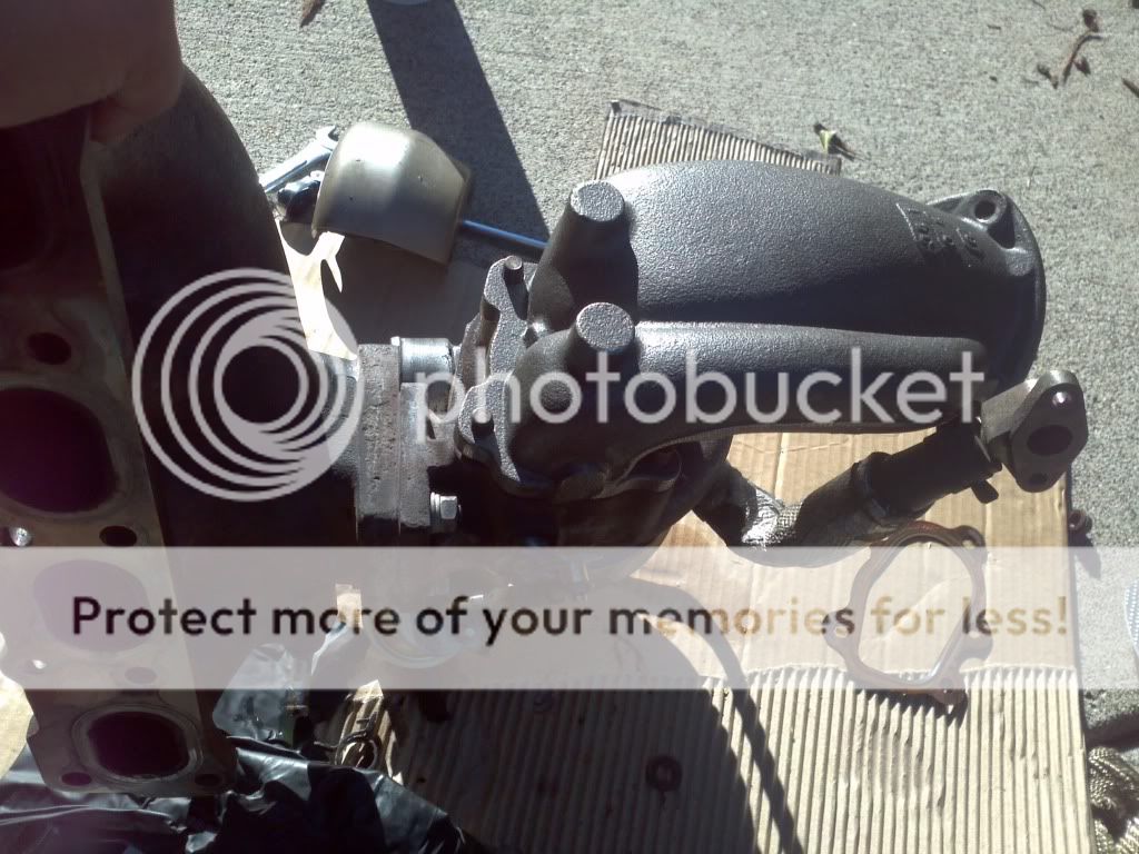

well heres some pics it a tight fit but ill update later gotta ride the bike to pick up the kids lol
may need spacer
