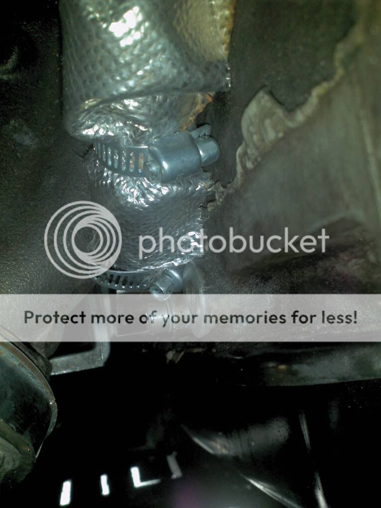

this is a hard angle but its snug up there...definitely the last part you put on after installing mani that way you know. your flat..
if i were you i would be thinking of creating a braket to hold all of that just like they did with the stock s-pipe
something to take the weight off the turbo and manifold.

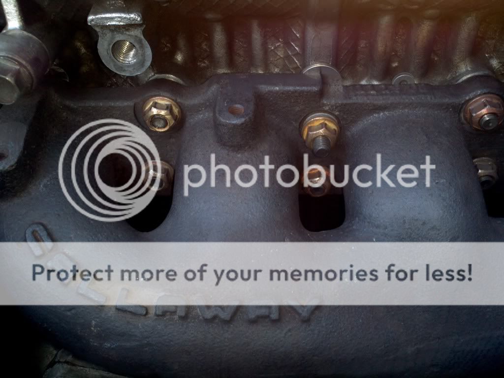

also, replace ALL manifold bolts with STUDS and use stainless steel bolts and washers.
also, replace ALL bolts on the turbo and downpipe with Grade8 Hex bolts or or just grade 8 bolts.
i did it to mine, haven't leaked once after so much abuse at the auto-cross
all studs replaced with grade 8 then i used copper nuts.Toyota dealer ship told me about them when i worked on a truck before.
My exhaust tick has returned. I've had to tighten down the bolts about every 6mos to a year for the last six years now. A few months ago it started up again but sounded a little different, a little raspier maybe. However, I checked the bolts and they were all tight. Oddly, the noise went away and stayed quiet for about a month, and now is back again. I am wondering if my manifold has actually warped slightly, and I need to sand it down as you did.
Not that hard just make sure you have a true flat plate or marble top to check flateness, also you should be able to rest the whole manifold on the sander. To make sure the whole surface is making contact. and dont press to hard just use its natural weight. takes a awhile but it will be true. Good luck.
If youre worried about them coming loose or if they do again, look into stage 8. I had a lot of issues with mine backing out and finally ordered them after trying multiple things
