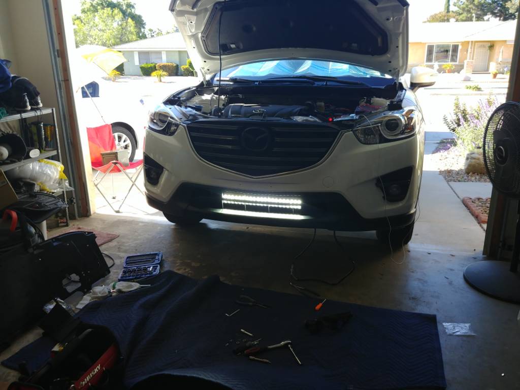

Here's placement of a decent light bar on my 2016. I wouldn't wire it directly to high beams as there's DRL issues as well as few other things. Easy enough to get a quote directly into the cabin and switch into wherever you want really. I never use the change cubby next to the arm rest so I put a switch in there it's a touch sensitive one so it's awesome. Wiring is easy and it gives really good night output. Could only imagine had a gone with a rigid industries light bar how well it would work down there. Main thing what year is yours?

Can we get close up pictures of how it is mounted? I am looking to do this to mine.
Anybody put one behind/inside the grill on a 2017+? I've wanted to mount one behind there but haven't really looked at how difficult it might be to get in there. What's the easiest way to access that space? From underneath?
Removing the front bumper is best. Really not difficult; it's too beneficial // makes it too easy not to. I added a RGB/ flood led bar (straight 22" with RF remote) to my '16 GT, hid the switch on bottom lip on the panel under the steering wheel.

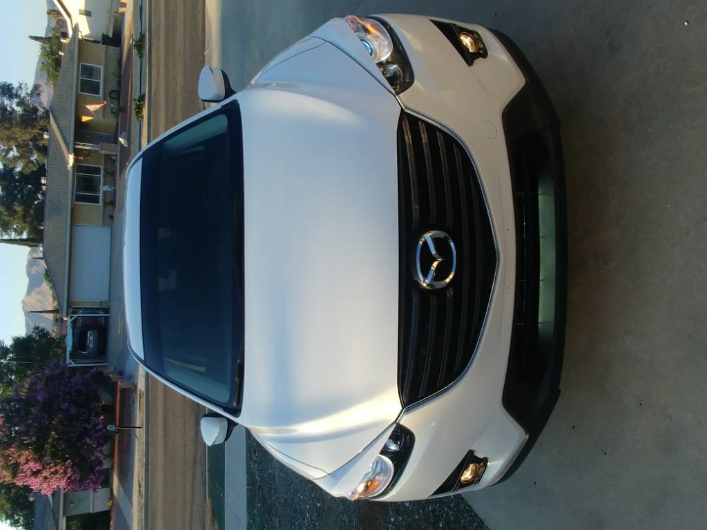

<a href="https://ibb.co/478pgVW"><img src="https://i.ibb.co/W6kfp2n/fullsizeoutput-52c2.jpg" alt="fullsizeoutput-52c2" border="0"></a>

I really like the way you put the eyelids on... Did you use plasti dip?
