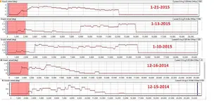

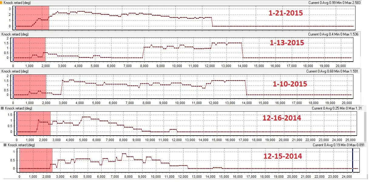

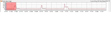

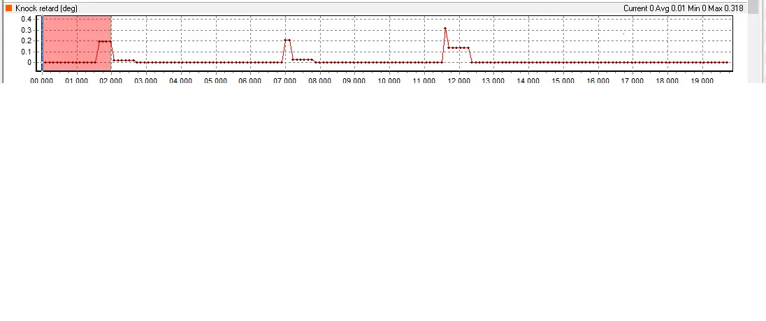

So from there I started going over my recent logs, to my utter horror, I noticed that my knock retard on my last 3rd gear WOT pull was knocking HARD the entire way through the pull. 2.58* to be exact. Digging into my logs more, EVERY SINGLE log was like that from day one. Getting progressively more worse with each adjustment. The timing being advanced further and further. (Ive attached a copy of my knock retard logs for every adjustment as well as my stock map knock retard log, youll notice it runs at 0* knock, with 2 minor fluxes which peaked at 0.318*, which is like I hit a small bump) This is a HUGE difference from 2.58*
In my research after seeing this, I have found out, that anything over 2* is VERY bad, the cars ECU also turns on its safety measures at 2.8* to try and protect itself. At the levels I was running, a thing called "peppering" can occur, which is scoring of the cylinder walls due to the piston literally being vaporized. I
