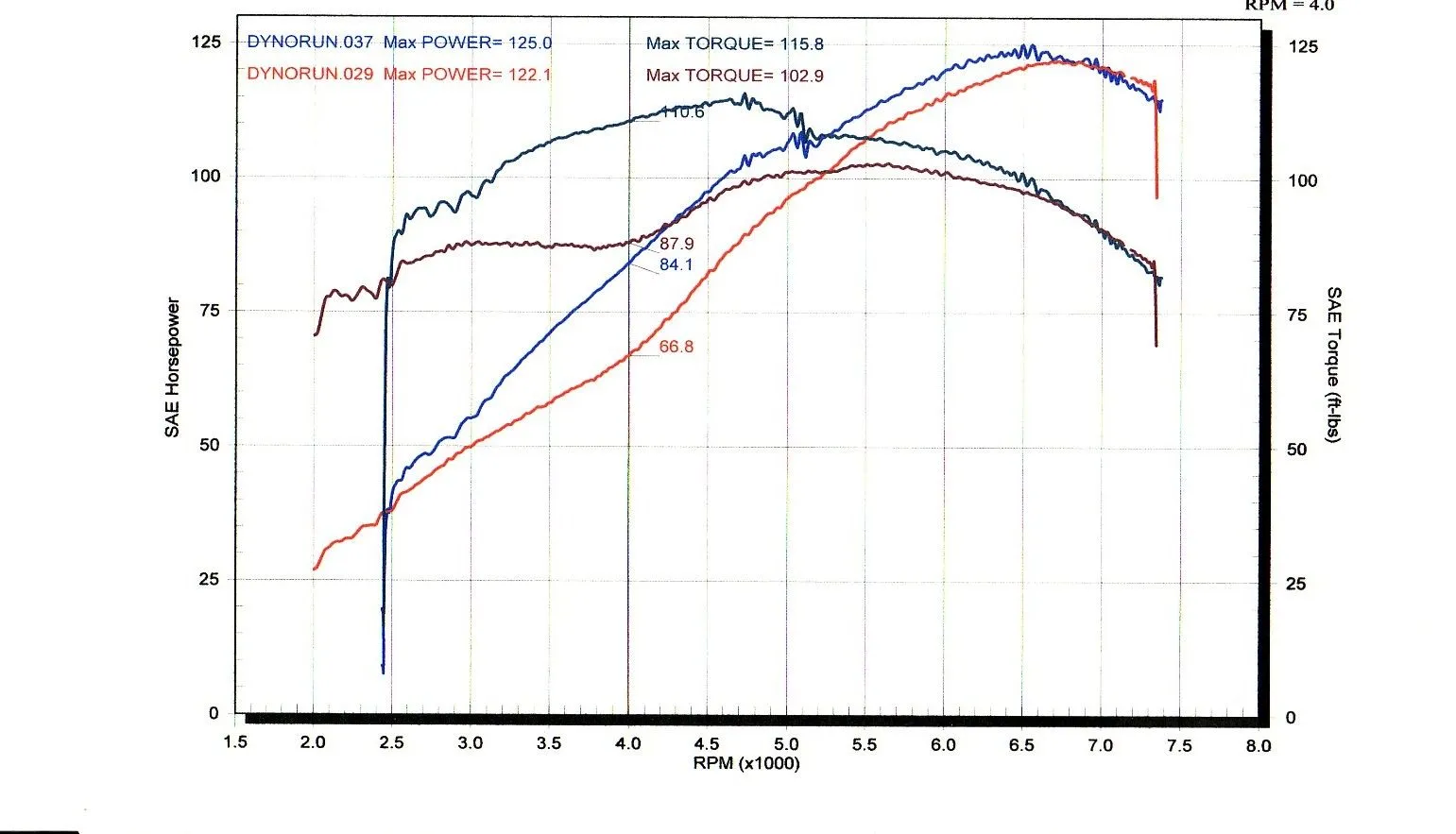

125whp and 116lb-ft of torque. I thought I'd get it out there. So with proper tuning on the dyno, my exhaust cam as an intake cam netted me 8whp and 4lb-ft of torque. Pretty awesome if you ask me. I should have got a printout showing my previous best before when I had 117whp, which was before the cam. The one of the chart shows the last time I was there, and I had the cam 3 teeth off because the exhaust cam is 45 degrees out of phase compared to the intake cam. And that run was done with the VICS manifold open, which is kind of like cheating. Anyways, I'm very happy with the results, as who would think the little 1.8 with only a few mods could get such good power. And this isn't even with a header.

Great numbers Josh! Damn, Im even behind you now as well. :) Gives me something to work towards.
scorch70
Ya, it was a great dyno session, as everything went smoothly, and seemed to fall into place. What I'm impressed with most, is the torque. My little 1.8 is laying down 116lb-ft, go figure. Car only weighs 2350 too.....can't wait to get back to the track.
You still haven't got the header installed? What is the comp. rate on your car?

Just like any car. Fuel cut. The longer you can keep it in gear, the more you can take advantage of lower gearing. Within reason. Torque would have to fall as low as 50lb-ft for 1st gear to be slower than shifting to second. That's why high RPM screamers can accelerate just as fast as those torque monsters. Cars with higher horsepower accelerate faster than cars with more torque. Especially if they can rev high.

Oh sorry, it's actually 8.8:1 if you can believe it. Miatas and the 94s with the BP have 9:1. So I'll have some decent gains going to 11.5:1 or 12:1.
Andrew, I use this one. It's near spot on with my previous time. My car's weight with me in it was 2650, and I had 132hp(117whp. About 15hp for drivetrain loss). My car is going to weigh 2550 for my next run, and I now have 140hp. That figures for a 15.2 on the calculator. I may even let my friend who weighs 150lbs drive my car, so that drops the weight to 2400 including driver. That's a 14.9 according to the calculator, but I'm not going to bet the farm on it. Obviously with the header, and some proper drag tires, I'll be in the 14s for sure in the spring.
