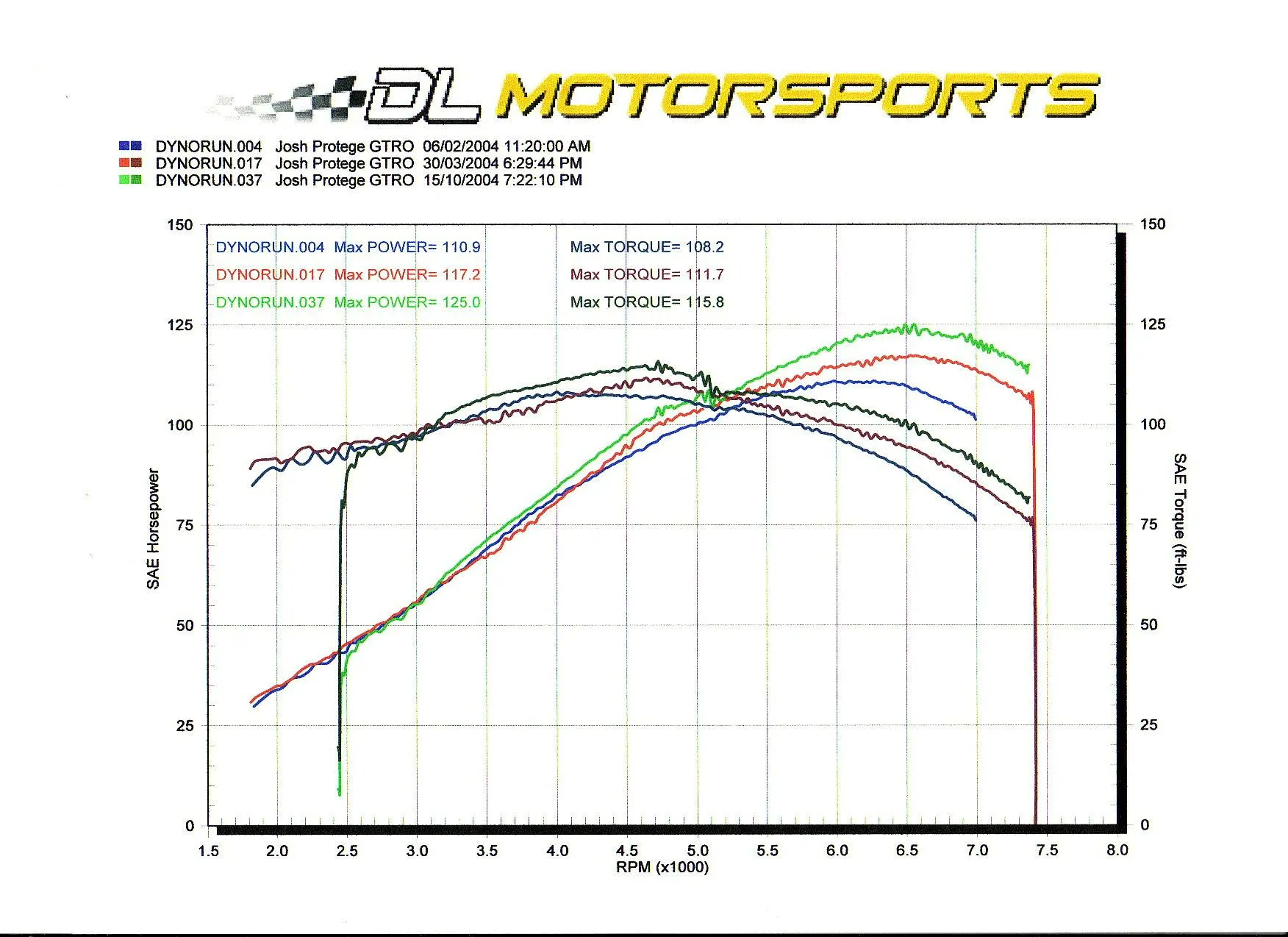

Here's a dyno chart that shows my baseline way back in February(Blue), my best power before the 'exhhintake cam' install(Red), and after the cam was tuned properly(Green). As you can see, then intake cam got me pretty good gains, the single best mod so far. I'm hoping the header gives me similar gains.

Yo, Josh--Realize you have the 1.8, not the 2.0, but out of curiosity, what are your cam spex?
202@.050". Conflicting reports on peak lift. Either 8.58mm according to Randy Stockers solomiata website, or 8.661mm according to Edwin Man's Proteg FAQ website. I'm going to go with the 8.58mm figure. Randy propably knows it's net lift, and Edwin most likely calculated gross lift. Although with HLAs, gross and net should be the same.
The BP is the other way around compared to the FS, wheras we have the exhaust cam which is larger than the intake cam.
