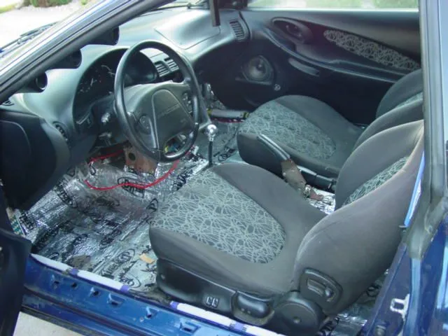

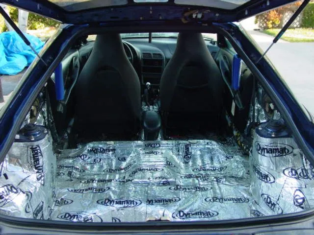

this is one of my older projects.....man was that car quiet......
wow, thats thorough! even covered the fuel pump access panel :p
seriously tho good job. how much did it total in the end
