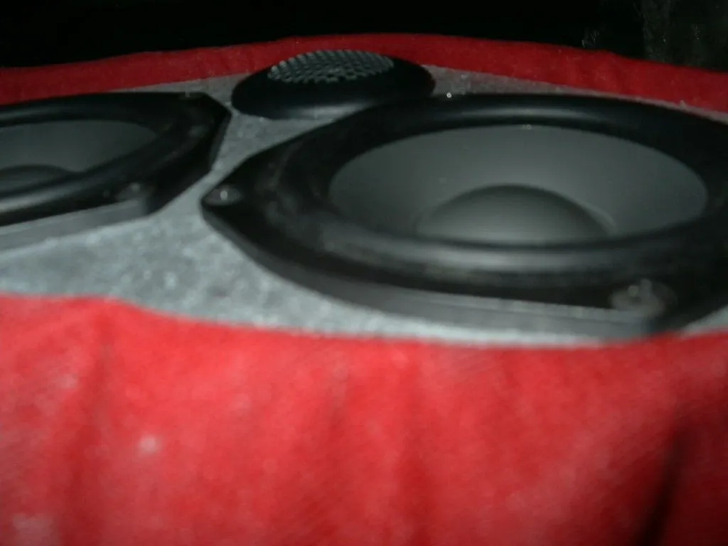

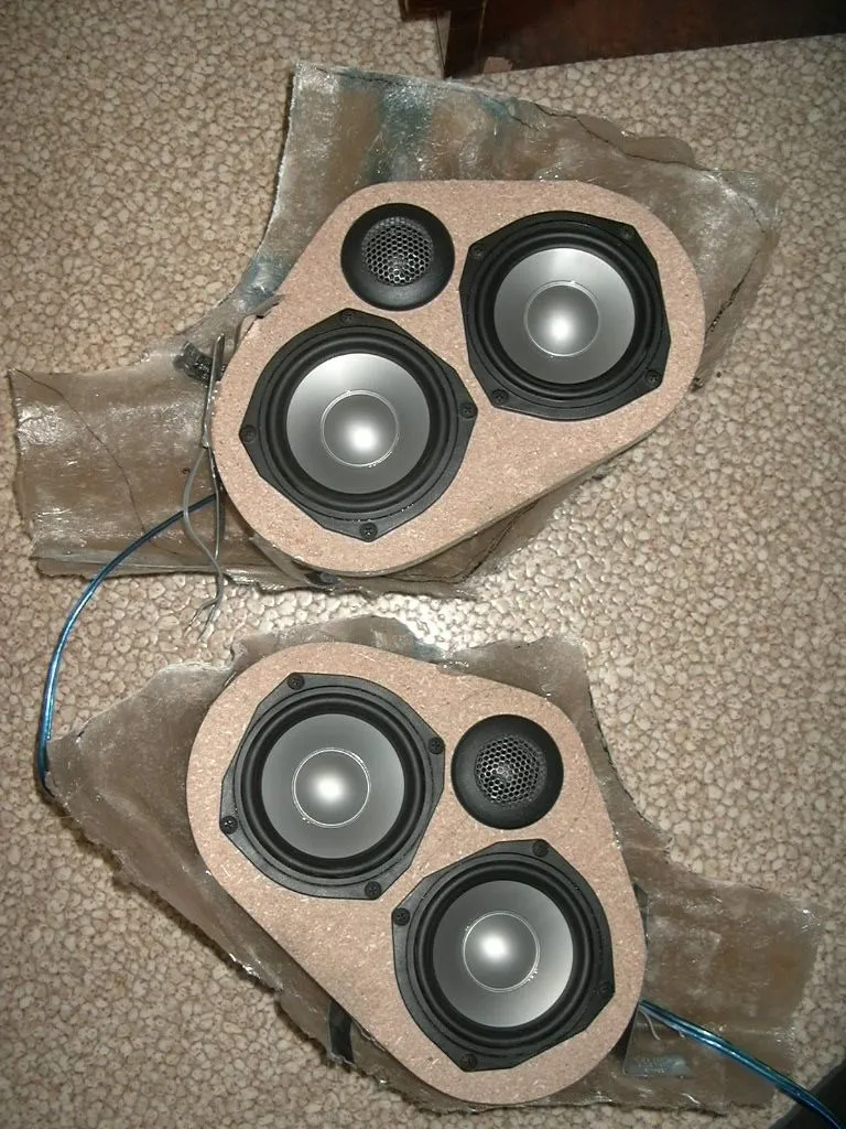

Got the backs trimmed to fit under my moulding, and anchored my speakers inplace (cheap strapmetal and hotglue) I'd had a strapmetal backpiece sorta "springing" it earleir that helped change positions yet still hkind of partway hold things in place, but this is a step towards more permanent.
For anyone who's looking into making some kicks take note that the footrest and pass side floorboard are not at the same angle, and also, the computer behind the pass side takes up a good bit of room, so the spacing is kind of different. I'm not being too anal about it all, or else I'd do something drastic like relocate the computer (it has been done, not sure on Proteges but some guys are nuts)
These things are freakin HEAVY... I'm sure those extra buckingmagnets aren't helping matters, but dayem. Hopefully the hotglue'll hold 'em sufficiently for a couple days while I make sure they sound good to me where they're at...

what are you cutting the fiberglass with, your teeth? lol best thing ive found so far is a dremel with a cut off wheel.
Dremel with a cutoff wheel actually, but i'll likely use airtools when I trim 'em up more. I've only really trimmed the arcs where they mate up with the rubber trim, Those actually slide underneath the trim, so I was pretty pleased to get thatpart to work. the jaggedspots are still just untrimmed fiberglass as it was layedup.

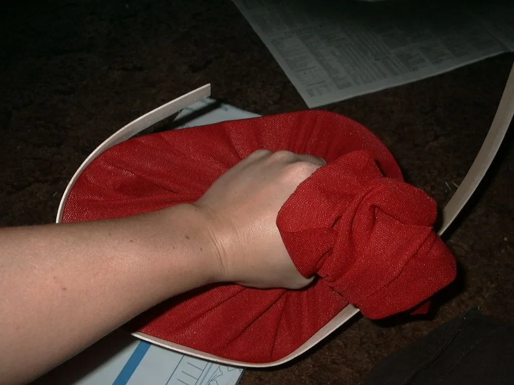

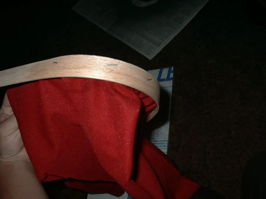

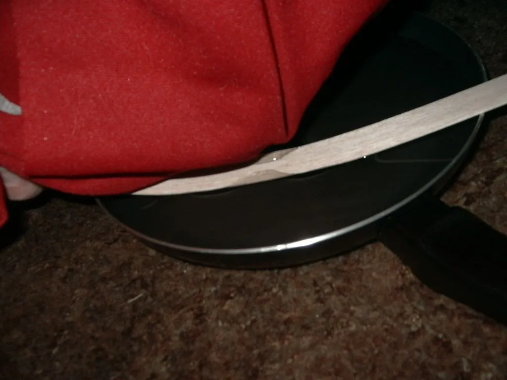

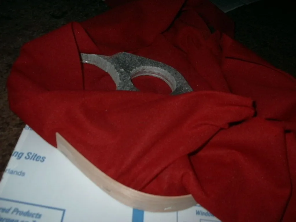

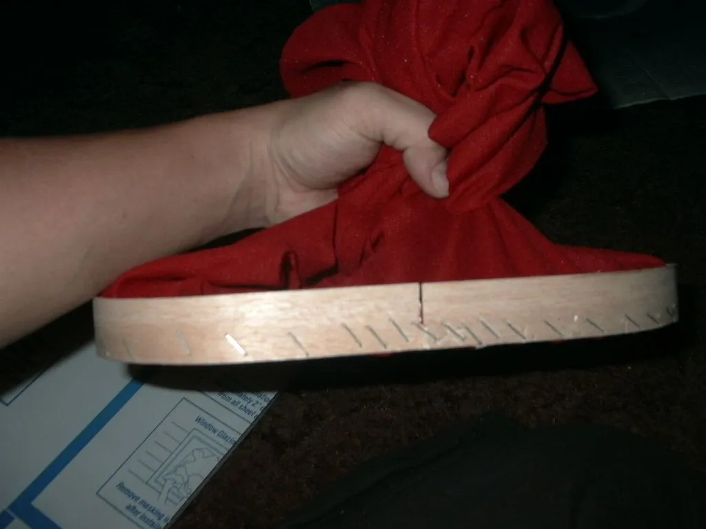

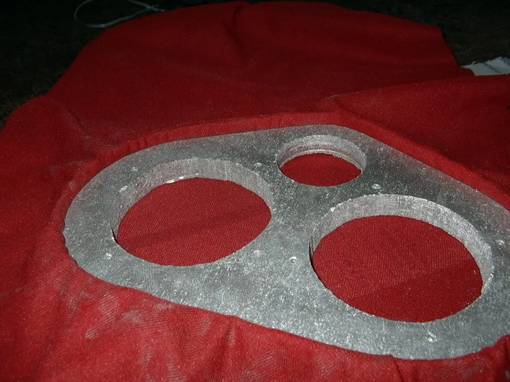

At anyrate. I've come up with a method for Having a raised lip surrounding my speaker plate which a grill should be able to flush-mount into. I guess we'll see how well it works out, but the theory is this. Stretch some grillecloth behind the plate, then wrap it with 1-1/4" balsawood. THis is accomplished by soaking the radiused areas in water (frying pan in the picture) THe balsa is stapled intoplace for now and I intend to coat it in resin to give it some structure (atleast enough to hold the cloth being stretched around the backside of my mold) I found that the corners are indeed kind of tricky, and I actualyl pulled staples and re-stapled a couplefew times before I settled on the method of "bunching up" the fabric in my fist to hold it taught around the sides soasto avoid wrinkles. As always, a couple extra hands would've made this easy, but I managed without.

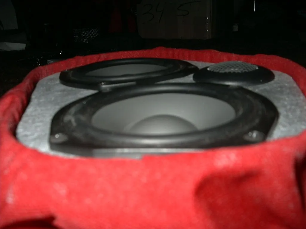

Oh, and By the way, the silver's just kind of a trial thing. I'm definately thinking some form of lighter color.. EItherway, there's alot of lovely MDF texture showing through as-is. I'll be primering and sanding a bit and making it look a bit better. Also I intend to finish the "outside" part of it with spray-can rhyno-lining seeing as my friends aren't exactly gentle (not do I expect them to be) and the way the driver's side one sits, I'll have the side of my foot up against it alot of the time it seems.

looking good. i'm in that same area, trying to make the trim piece so the speakers are recessed, i'm using a thinly trimmed piece of birch, paint to get it as thin as i want it and shaped right, think the bals reinforced with fiberglass might be a easier route.
I sat there in home depot bending woods (hehe I said bending wood) for a couple hours, and even broke a few pieces (I gladly paid for them) before the guy took me to the scrap section and said have at it... I settled on the balsa. Then got the thickest that I could without being too brittle. I think I'm on the right track here. I can't even remember the thickness anymore, but I'll be buying some more tonight seeingas I didn't get one of my pieces wet enough before attempting to bend it, and Snap... funny how the stuff works. SUPER clean break, though. I'll likely see how much resin I can soak into the stuff tonight, I'll post up how it goes. I'll prolly be mixing it up light on the mecp to let it soak in as good as possible.
it shouldn't have any problems soaking into balsa, that stuff should just suck the resin in. i just worry that it won't be strong enough even with the resin. may need to add some cloth on it to bond the two to the kick and strenthen it up. it's hard to cut a damn 1/4" thick shape and have it come out straight.
An art supply store (A.C.Moore, Michaels, etc...) usually has balsa wood in the size and thickness you need.
snds> you talking about running a strip of fabric or something around the inside of the new "lip" I've created? I was actually thinking I coudl jsut use a fat strip, and fold it over bring it around outside, or whatnot, but I'm thinking just the doped balsa should suffice. I'm not really going to need to pull a huge amount of tension against it, I suppose we'll findout, as soon as I can find more grillecloth and get the otherside ready thatis. I still need to trim these damn things as well.... hmm. buddy should be at his shop rightnow. I need to get off my ass and go get this done, my car sounds HORRIBLE now that i got used to having these beauties inthere.
oh, and the balsa I used was 1"x3/32nd I believe. Knowing now how bendy it'll getif you soak it long enough. I could've prolly went for thicker, but hey this seems like it'll work alright... I actualy picked up some more at the local family-hardware-store.
Hmm... new thought. perhaps I could wrap some yarn around the outside of my wood wall, that should soak in some resin and add some structure... Possibly give me a softer edge that won't be as pointed as well. Actually now that i think about it, there's some round-cornered balsa down at the hobbyshop. Hmm... Alright I'm off to go seek inspiration.
Balsa is so soft that you could just take a piece of sand paper, curl it over the edge and sand the corners down nice and smooth.
