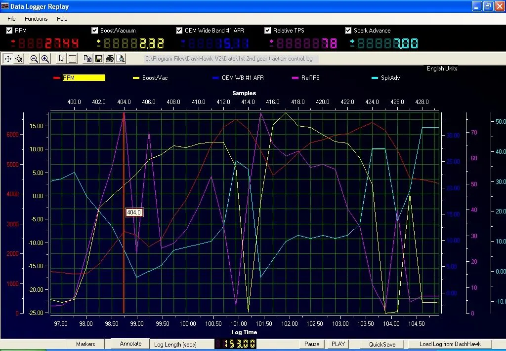

Nope. I did this test the other day while logging with the DashHawk. I wanted to see exactly what the car was doing when DCS was ON or OFF (just pushing the button once).
With it on, I rev'd it up pretty high and dumped the clutch. The light came on but it immediately cut power then resumed once it got traction. the log showed boost was normal but the throttle closed from 78% to 23%. It actually did it twice in a very short period of time. You can see it starting to close it in the log where the cursor line is.
With the DSC off, I was able to spin the tires completely through first and into second. No power cut at all. I can't find that log right now but here is the one with DSC ON.
I'll try repeating this test later this week comparing DSC ON and OFF and TCS/DCS OFF.
