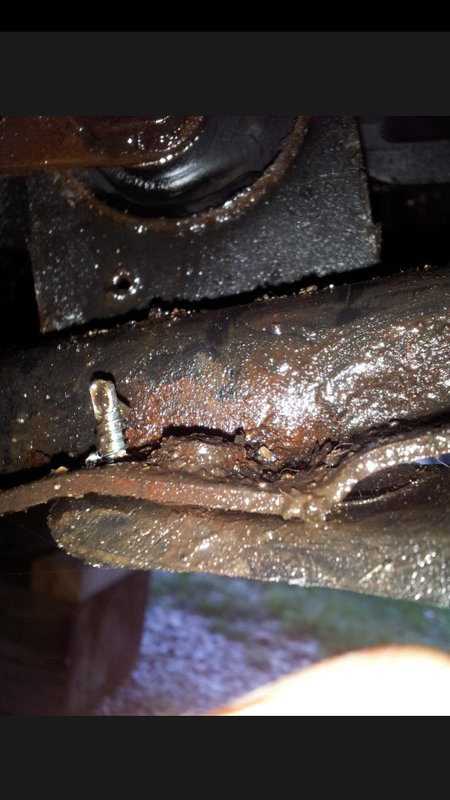

At some point in my car's life someone has hacked away the splash shields with a utility knife, if they were intact it would never be an issue.
I'm happy to say that all my splash and heat shields are still in place !!!
Zip ties, Self tapping screws and all..
