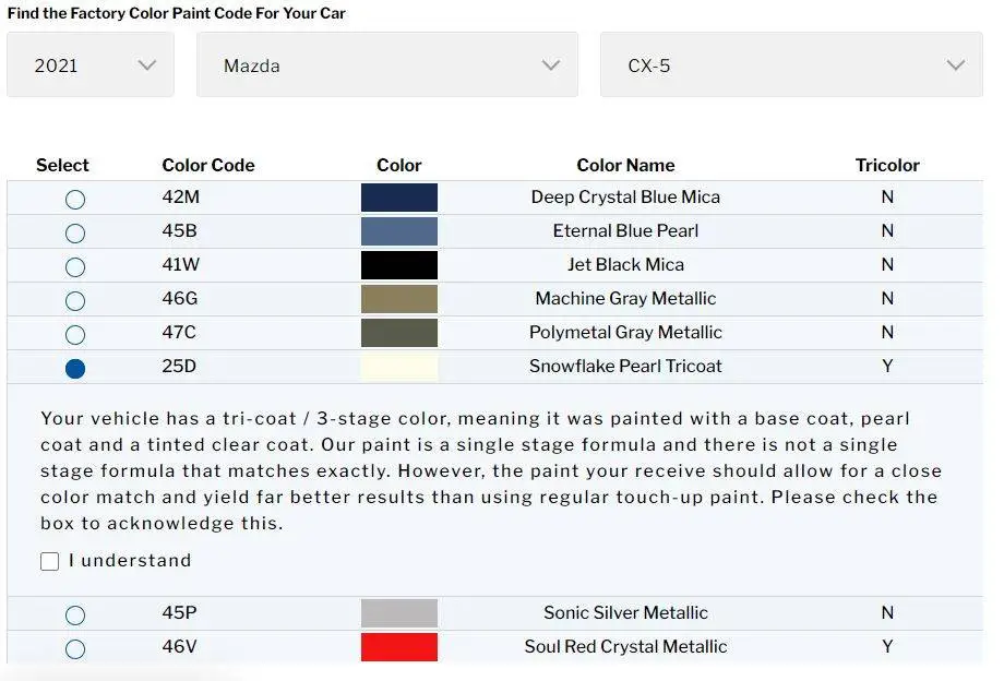

If I will get results like the picture you provided in the link I will spend $90, in pictures you can not see where the chip was, but on the other hand they are stating that the pearl color code 25 D will not match.
From the website:
Single stage paint will never be able to match tri-colour paint, but it should be closer than regular touch-up paint (i.e. OEM paint pen), which is basically what everyone's been saying all along.
