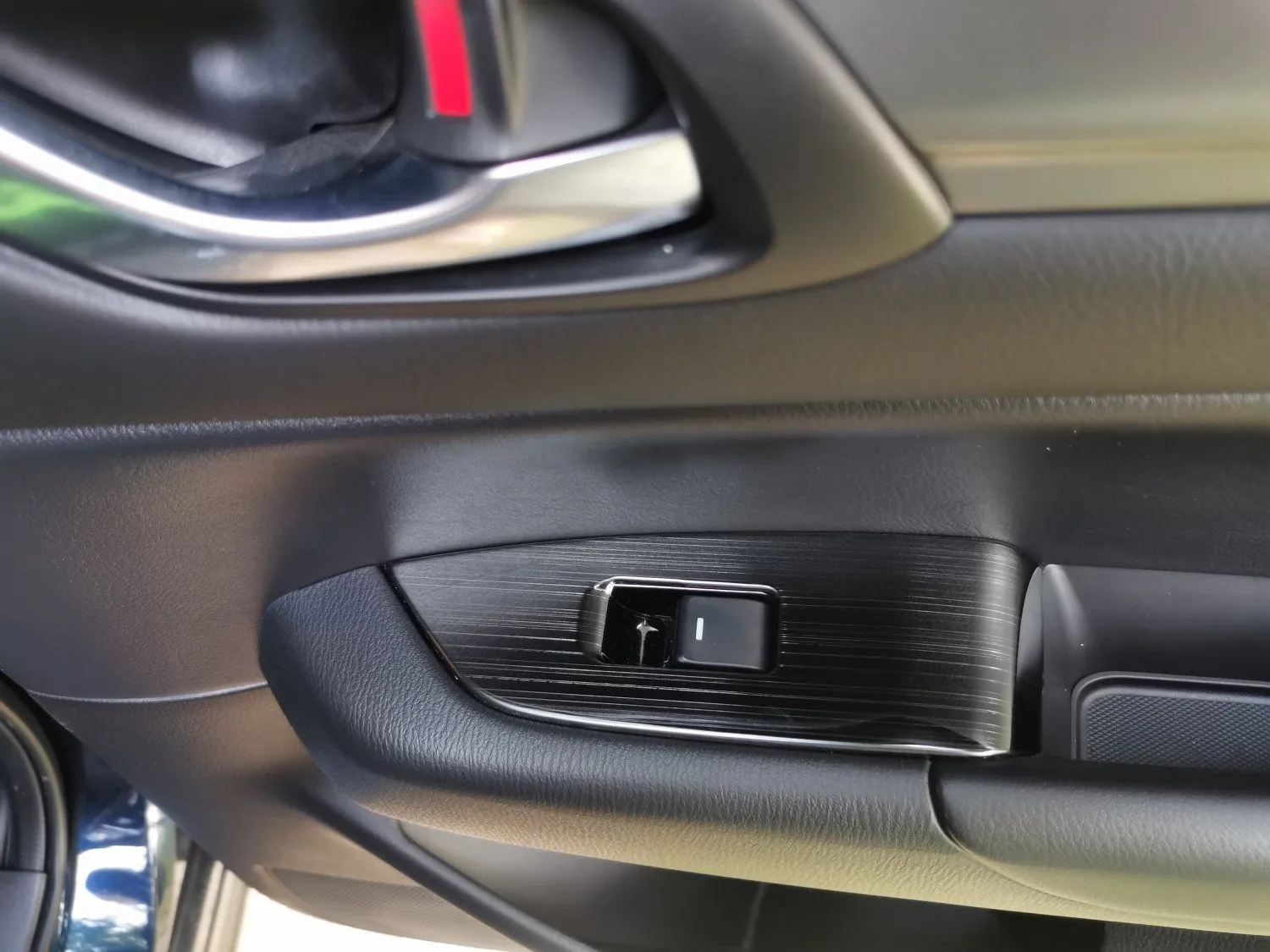

It seems the rest of the world does NOT get the unlock button on the front passenger door. This is a problem when trying to source trim pieces to snazz up the interior.

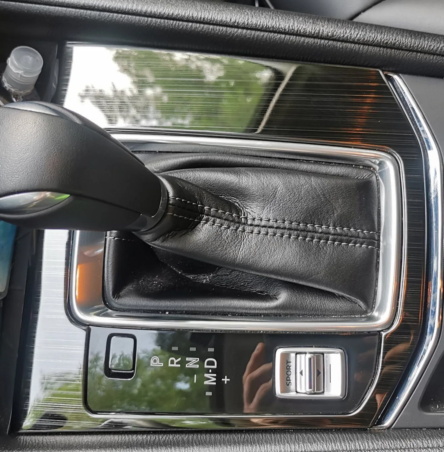

I want pieces to match what I did in the center console

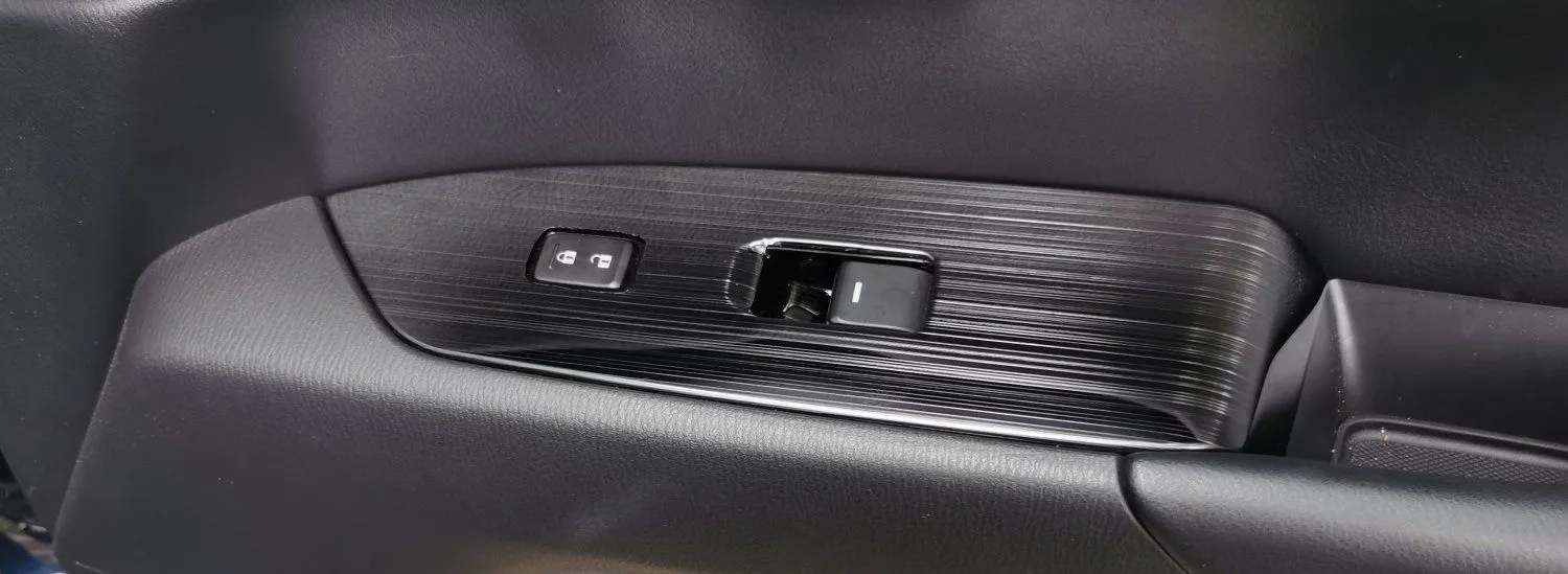

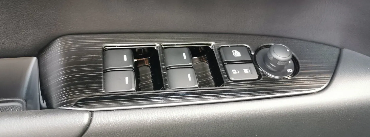

Took a chance with the trim pieces and it worked out! Ordered the set of door trim pieces from China (where it seems they are all made) and after half a lifetime, they arrived. I modified the front passenger door piece using a dremel tool to create the door lock button hole. The process I came up with was to cut out a piece of painter's tape to match the window button. Lightly stuck that piece of tape on the button with the sticky side up. Pressed the trim piece on top of the door panel so that the painter's tape stuck to the location for the missing hole. Then came the tedious part- cutting out the opening with a dremel tool with a cutoff wheel. Made the hole slightly undersized and used a fine grinding stone bit to gently enlarge the opening to the right size and, at the same time, remove the sharp/rough edges. Did a lot of trial fittings to get the opening for the switch correct. Finished off the cut edges with a black Sharpie so the raw aluminum doesn't show. The result was well worth the effort! Have the matching pieces installed on the console, cup holders, rear armrest, and rear console vent. It's a subtle change, but I like the look better than the piano black surfaces.

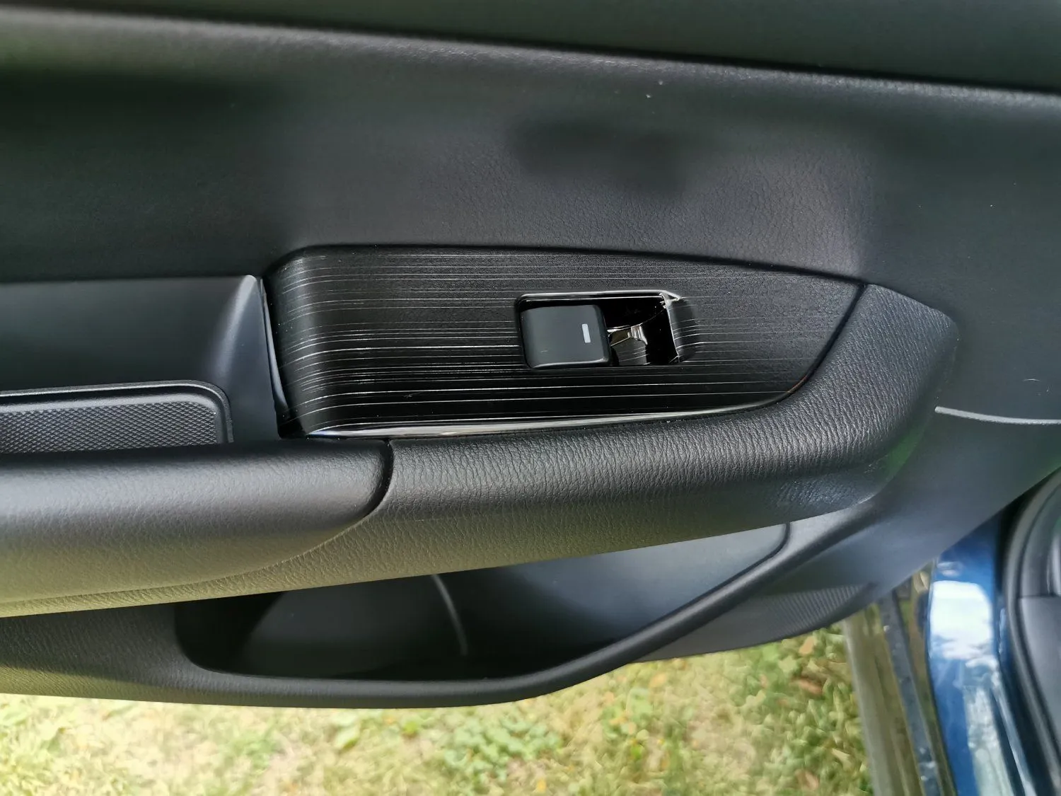

Literally just did this exact thing this afternoon. The 4 doors and console piece were $30 shipped from China to Canada. Took about 6 weeks to show up. I couldn't find a north American version either, so I cut the hole with some tin snips and a file to round off the edge. Used a piece of double sided tape on the lock button to stick to the bottom side of the trim piece as a template to find the location to cut.
I'm pretty happy with how it looks.
