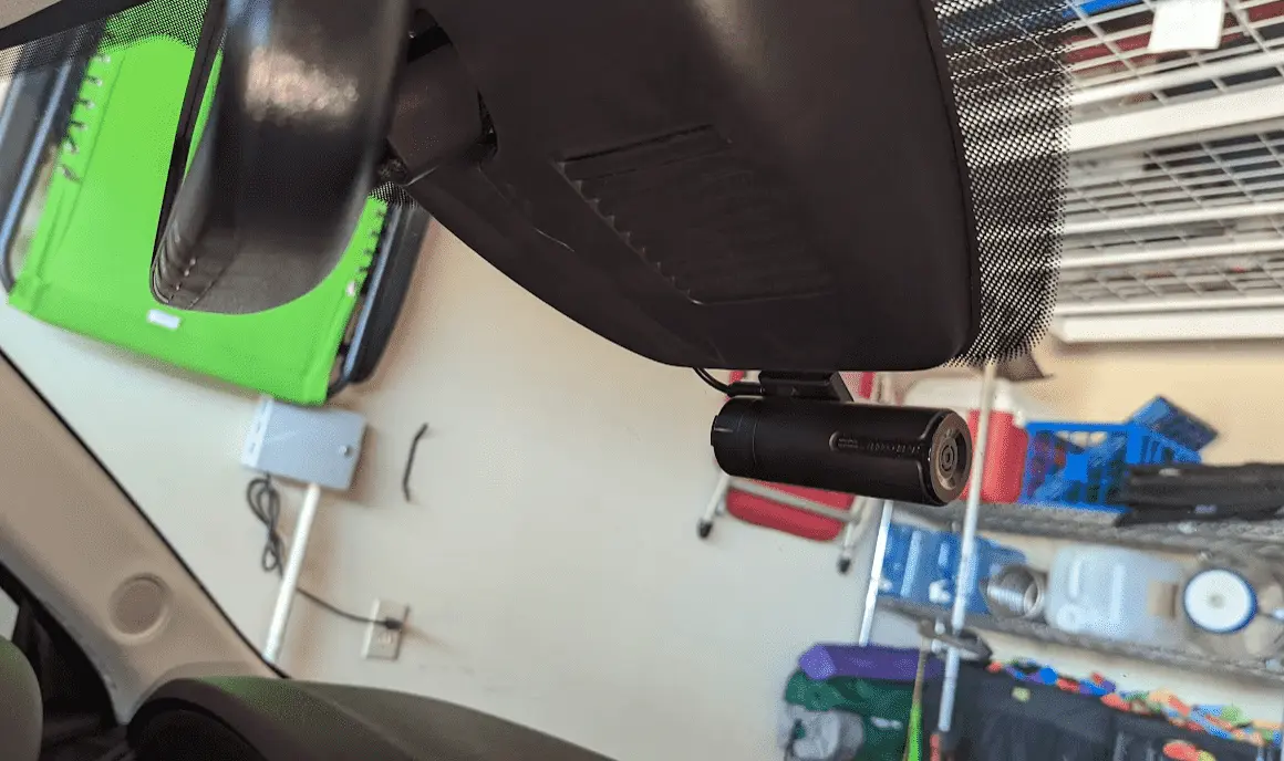

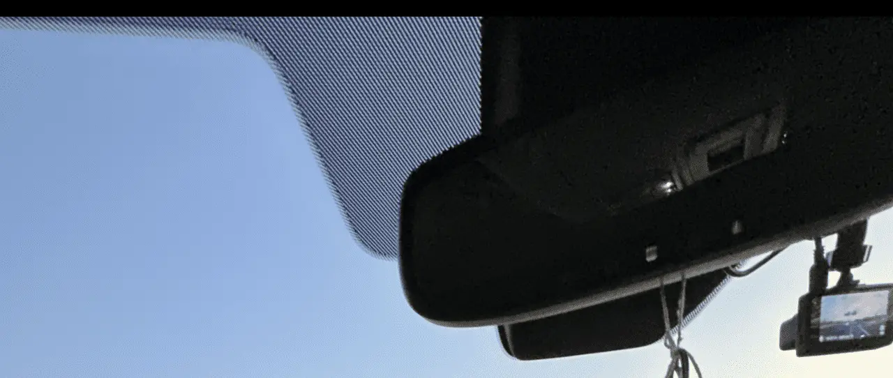

I can confirm that the Donger from the Amazon link works perfectly on my 2022 CX-5 S non-turbo with non-frameless mirror, plug and play! My garage door opener works when power to car is off and dash cam turns on when the car starts.
My only issue was getting the mirror cover off which took a little bit of work but I got it done.
The dash cam is mostly hidden behind the mirror from my point of view when driving and I do keep the screen turned off.

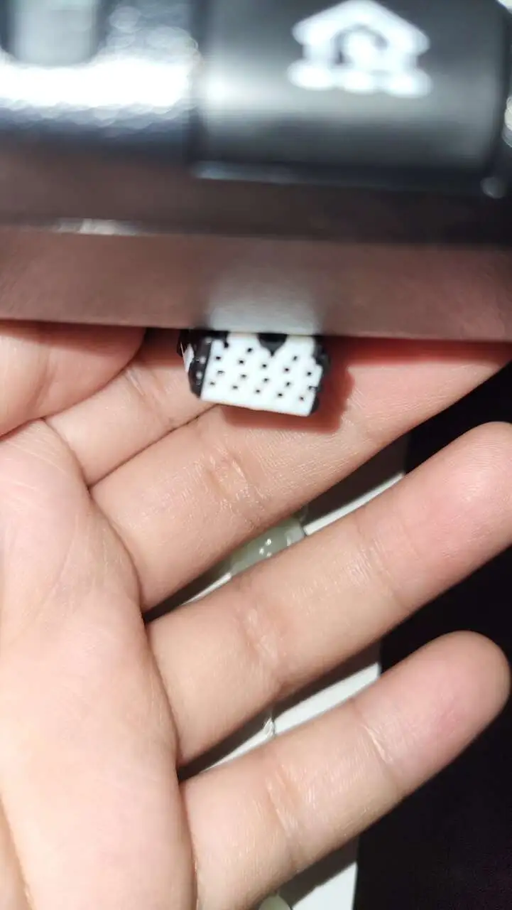

If you have the framed mirror with the older 10-pin plug (as seen below), buy the Type A.
If you have a different plug, buy the Type E.
Though it may be best to buy both and return the one that doesn't work. I've heard that the framed mirrors may use the Type E plug from the frameless mirrors.
