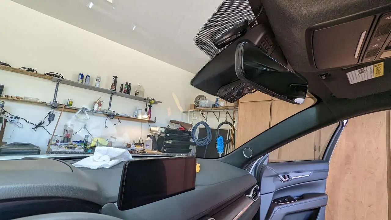

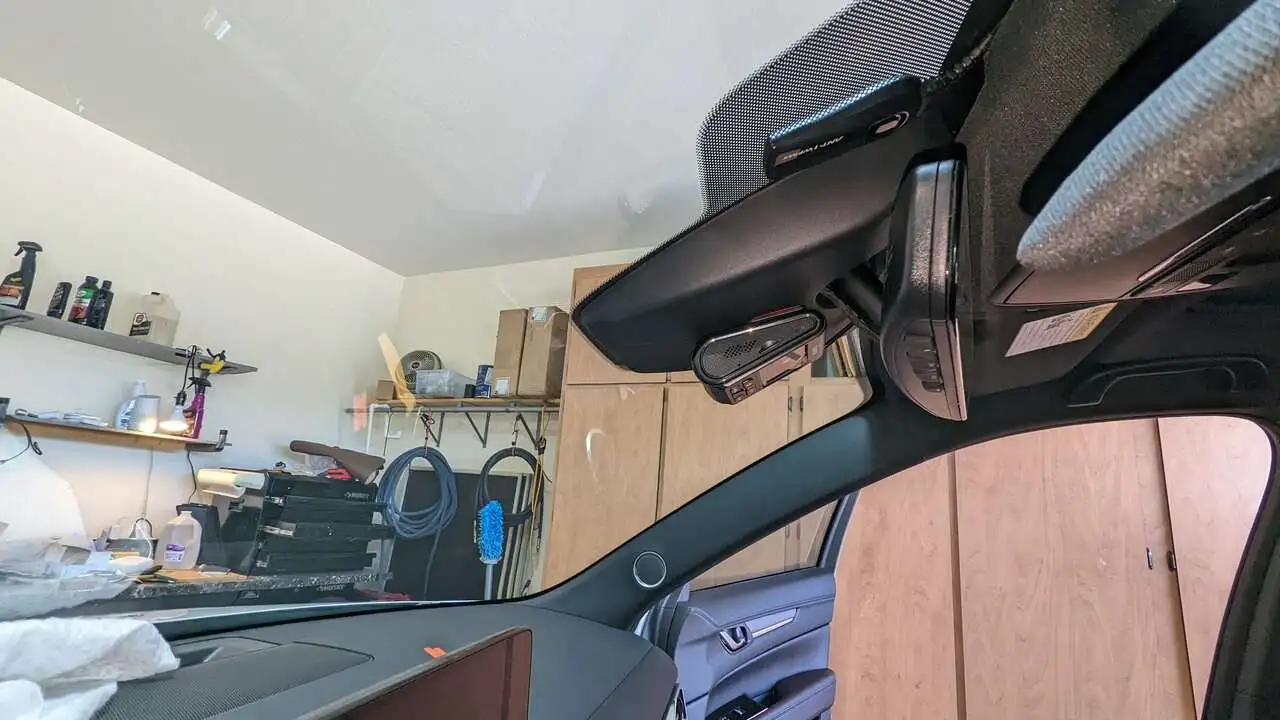

Amazon doesn't have the Doingar adapter for the frameless mirror, ordered directly from Dongar, came in about 3 days. It took longer to get my car keys than it did to install. Attached video is from the Dongar website. Key is to separate, not pull down, on the cover in front of the mirror. Love the Viofo camera form factor
Finding the products were as easy as installing them, just Google Dongar
Exactly - kind of. It's the Viofo A119 V3. Love the form factor, universally accepted as one of the best rate , lower-cost cams

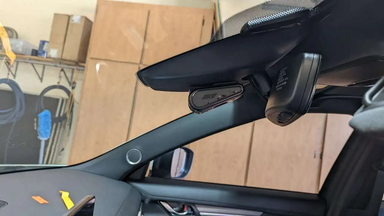

Nice job! What is that other thing stuck to your windshield? looks like some sort of GPS

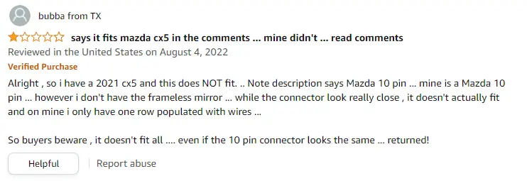

This product only works with models w/ frameless mirror due to diff in PinOut patterns. One reviewer confirmed it.

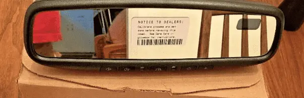

Yeah I have a 2022 CX-5 S "preferred" Its a lower S model with some gadgets added on.. and it still had the auto dimming homelink mirror. Evidently in 2019 then went from a mirror with a black plastic border. Someone with more knowledge can correct me. but I don't believe the mirror has changed since they went to the frameless. 2017-2022 Mazda CX-5 Mirror, Auto-Dimming, Homelink 0000-8C-R06 | RealMazdaParts.com

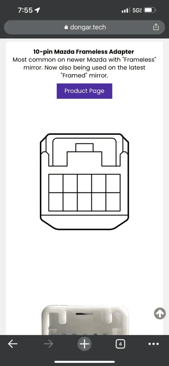

Donger’s own website says it will fit newer framed mirrors, and I have a 2022 not 2021, but I guess I’ll find out this week
It will fit. I have a 2022 and it fit fine. Its odd about the 2022 CX-5. It has been out quite a while.. but over and over, I see accessories that are listed to fit up to 2021. I saw this with floor mats, LED bulbs, console trays etc.
