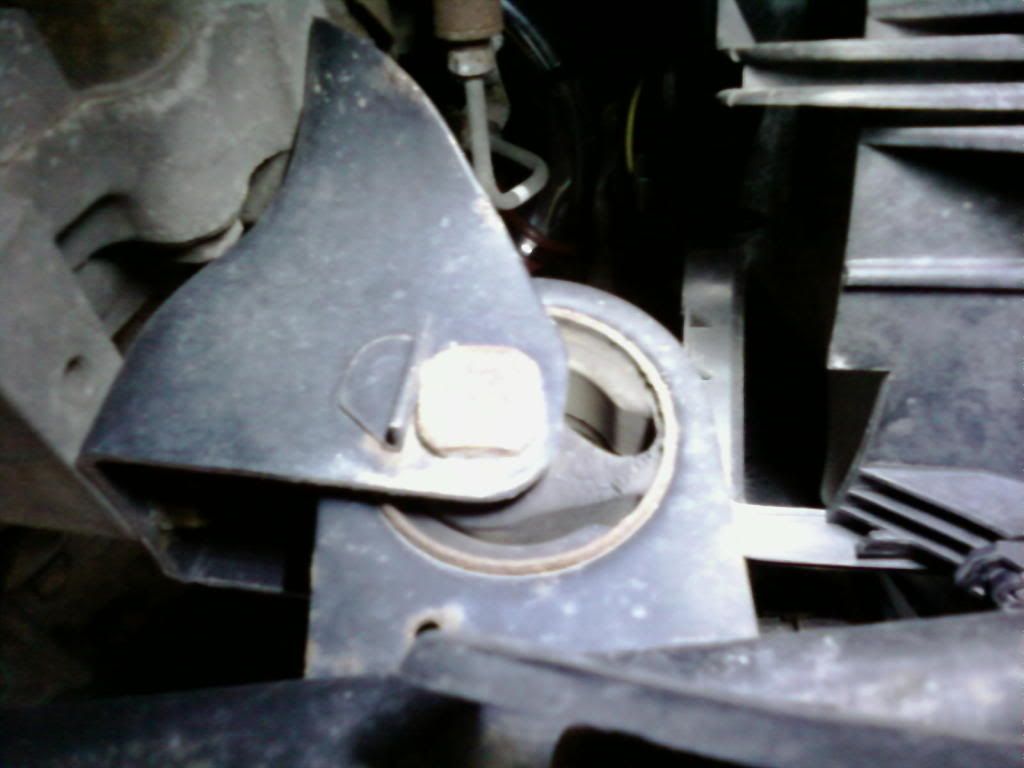

so as you can see from the picture, the mount is sagging towards the rear of the vehicle. do i need to replace the mount?
ive also been noticing that when the RPM's go down (like in stop-and-go traffic when im on and off the clutch a lot) i get a rattle from the engine bay. my assumption is that i need new mounts. but i dont know if i need to replace just the front or if i should do all four. also, if i do go replacing them should i go OEM or aftermarket inserts/mounts?
PS: rust sucks.
okay well again, should i replace all four or just the front? maybe just front+rear?

When parked the front mount doesn't really support anything so the bolt should be pretty close to center. Since it is not I'm guessing your rear/sides might be shot as well.
