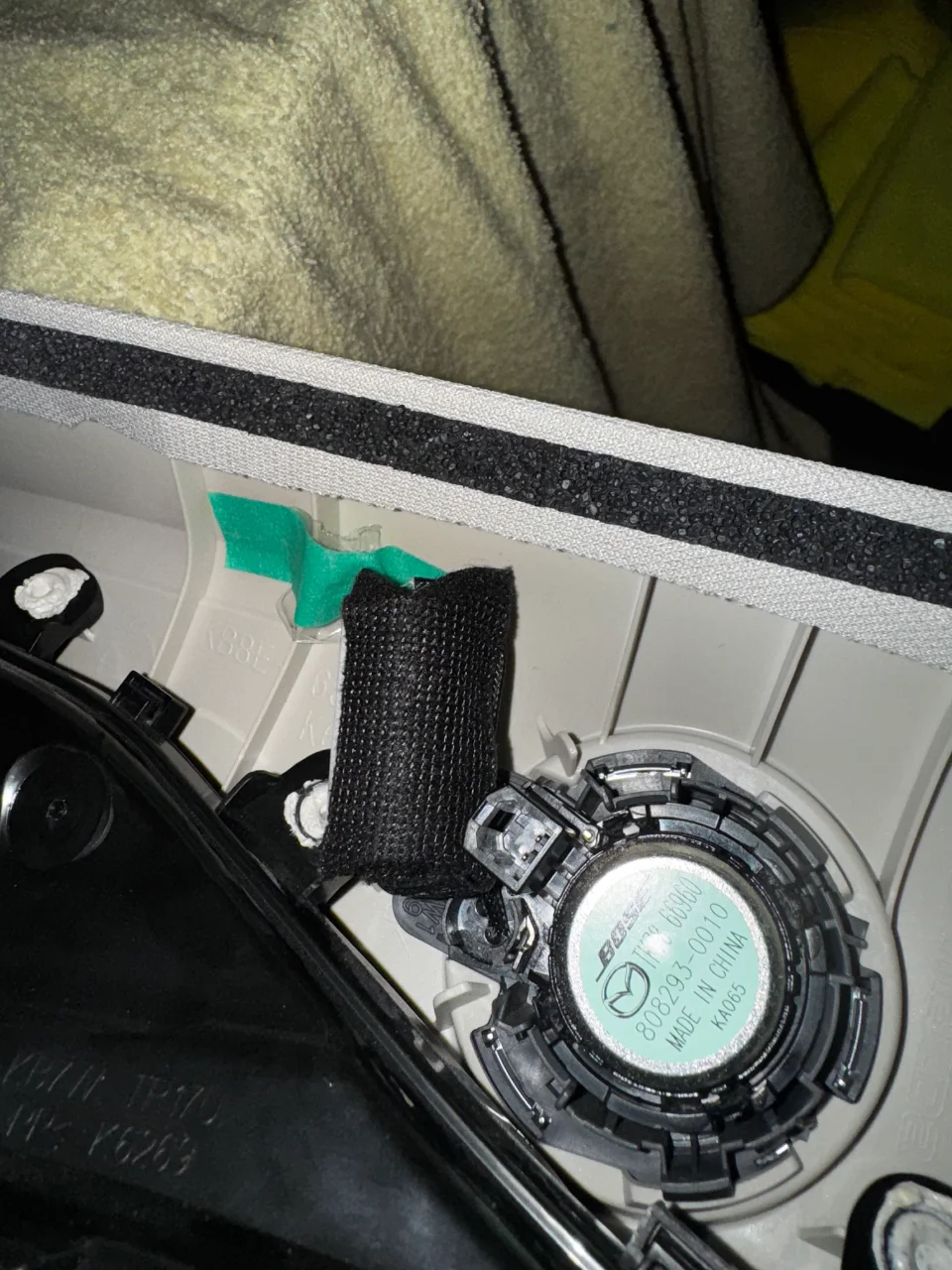

Not sure if this is the right place to post as i couldn’t post in the diy section. Anyway,
Difficulty : Easy.
Things you need.
1. Soldering iron
2. Audio grade MKP 6.8uf capacitors (matched pair)
3. Tesa tape (to prevent rattling)
4. Insulation tubing (for the capacitor’s lead)

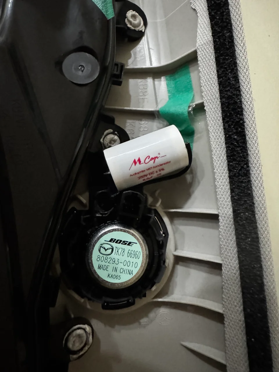

Remove the A pillar and tweeter, desolder the original electrolytic capacitor (take note not to overheat it. You could melt the plastic.)
Replace the capacitor with audio grade mkp capacitor. You get a more detailed high frequency and smoother sound.
Any mkp capacitor works. As for how much improvement depend on your choice of capacitor.
This mod is very low cost with a good result.
Careful of the size of capacitor you choose, if it’s too big you won’t be able to put the A pillar back.
The capacitor i used has 20mm diameter (theres still extra room for bigger capacitor)
Enjoy the music.

Any year and models work. The rules is simple. As long as you replace electrolytic capacitor to mkp capacitor will get a better result or no difference. You won’t make it sound worse for sure.
