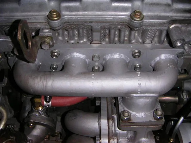

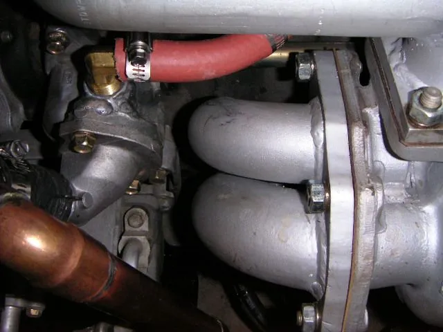

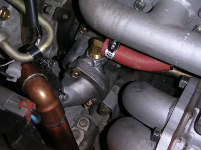

What did you do there? Looks like theres a lot of welding in there.
Im not sure what pic your talking about, the link says access is denied.
If your talking about the thermostat housing, I had 2 problems. 1 was the clearance of the outlet. That was easily solved by flipping the housing and making a 1" copper pipe to fit back in place of it.
The welding on the side and top was to cap the hole where the front pipe came in and then I welded a coupling on top, threaded in a brass barbed adapter, cut off the pipe back about 4" then connected it back together with a piece of hose (the red hose you can see on the top of the housing)
Is this what you were asking about?
