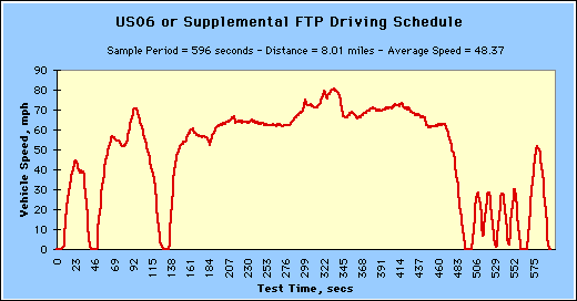

The EPA highway test cycle involves a LOT of acceleration and deceleration.
Compared to the Jeep, the CX-5 does not use much fuel to accelerate because it's light.
The heavy Jeep uses ALOT of gas to get all that mass up to speed, but once it's there the V8 only uses maybe 20% more than the CX-5.
