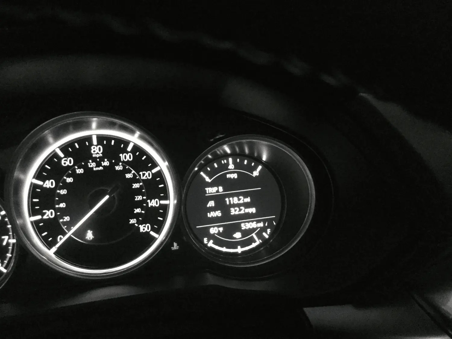

As I said a couple of times, the real time MPG monitor in my vehicle (US 2020 Touring AWD 2.5L gasoline) is not a touch screen function. It is in one of the display options in the right pod of the instrument cluster. That pod has four display option. You hit "Info" on the steering wheel until you get to this display:
The gauge at the top of the display is buried at zero in this picture because the vehicle is running in park where you get zero mpg. I will not be taking video while driving. I can assure you that as the vehicle is driven that guage bounces around in real time in sync with the cylinder deactivation display. That mpg gauge can be used in lieu of the cylinder deactivation gauge if you have some other use for the screen once you know what to look for which I covered previously.

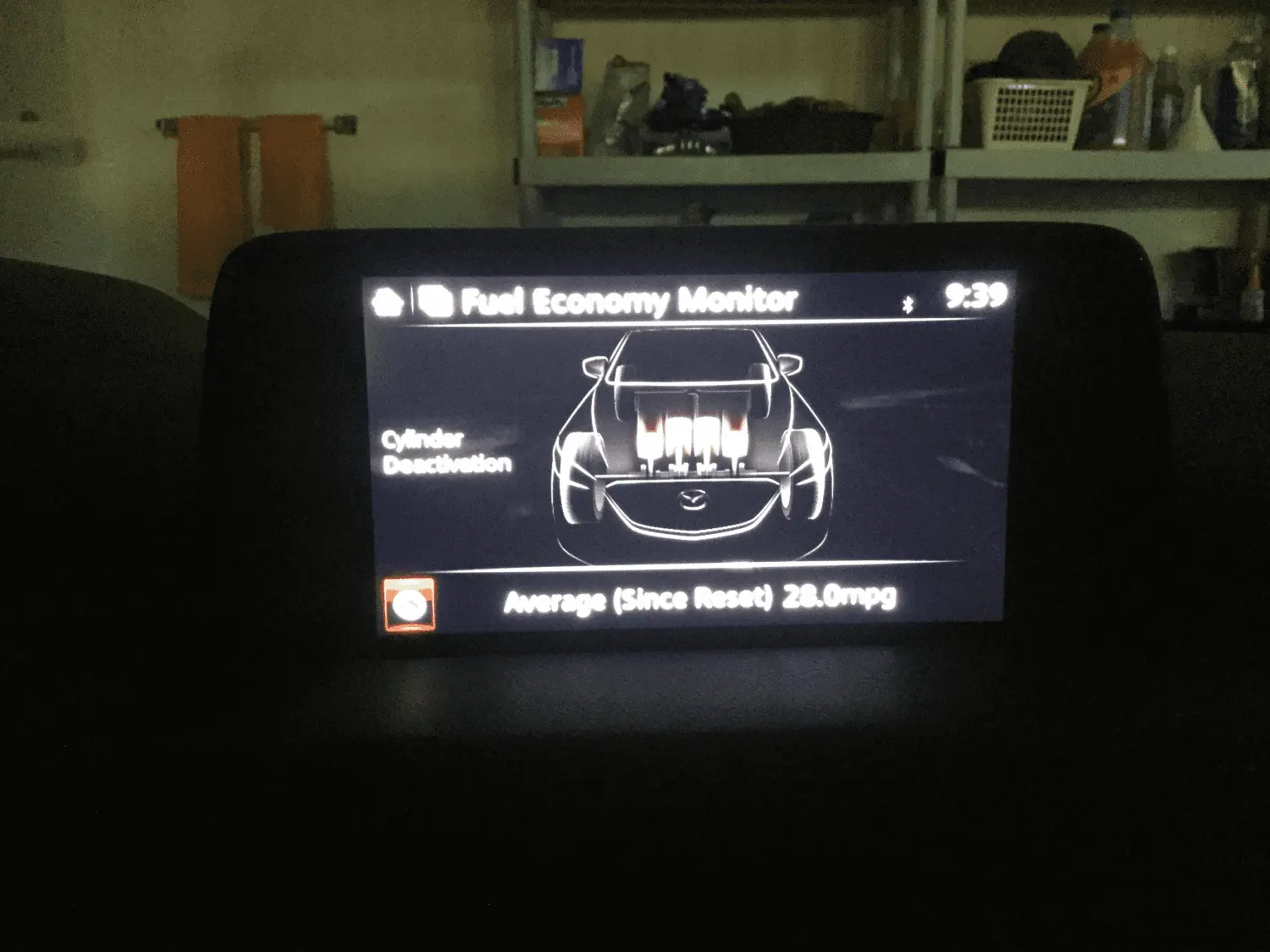

In my vehicle the cylinder deactivation monitor is displayed on the touch screen by going to Applications > Fuel Economy Monitor, not "Information > Fuel Economy Monitor" as stated by the guy you quoted who has a 2019 Mazda 3. That screen display in my vehicle looks like this:
With the engine running and the car in park, the display shows all cylinders firing. As stated earlier, my tests show this is always the case under 10 mph.
