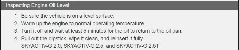

I think it's pretty obvious what they mean when they tell you to warm up the engine in the previous step. But if that's the way you want to interpret it, that's fine. It's your car, do what you want.
The problem to me is you claimed Mazda specifies checking the oil level not when the engine is cold, and this isn't a matter of opinion, its a statement of fact.
But in fact Mazda has never mentioned warm or cold, only says wait for at least 5 minutes.
It's obvious to me that they mean exactly what they say. Wait at least 5 minutes. That means anywhere from 5 minutes to infinity.

Again, do what you want. If you want to focus on that one single step and disregard the previous direction to warm the car up, go ahead. Why bother including a step to warm up the engine if they didn't want you to check the oil level when warm? <- (This is a rhetorical question, btw)
I'm going to have to agree with sm1ke here. Why would Mazda say to warm the car up at all if they didn't want the oil checked while the engine, and oil, were warmed up?
Yes, they didn't explicitly say that the oil should be warm but if they didn't want it to be warm why would they say to start the car and wait at least 5 mins after shutoff to check the oil? To me that says check while warm.

Because cold oil is more viscous. Right after an oil change, it doesn't flow well, and is coating the surface of lots of things. It will take a long time for cold oil to settle into the pan that the measuring stick dips into.
Warming the oil reduces its viscosity, making it much easier to flow, and reducing substantially the amount of oil film that clings to all of the surfaces, allowing it to flow into the pan. Like the difference between maple syrup from the fridge, vs. hot.
The easy way to warm the oil is to run the engine.
After warming up the engine, then shutting it off, it still needs some time for the, now less viscous, oil to drain back into the pan. They say wait at least 5 minutes because by then the vast majority of the oil that is going to drain into the pan has done so.
I didn't re-read this thread, but I agree with the poster who suggested that 12 hours or 36 hours count as more than 5 minutes, and measuring the oil cold after a long time, satisfies the directions (assuming the engine has been run since the oil change).
See post #49, the manual does explicitly say that the engine should be at normal operating temperature, so yes, warm oil. And oil does expand when it warms up so a cold oil reading will be different.
