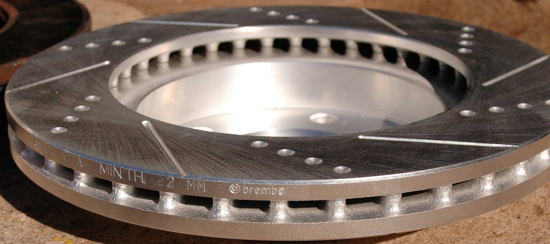

there is a big differenve in wet weather stopping. since i installed my powerslot dimpled/slotted rotors i noticed alot better braking when driving in heavy rain. the slots seem to suck out water alot quicker than letting the water naturally burn itself off because off friction. as far as drilled rotors i stayed away from those cuz of numerous posts from people that had those type or rotors crack right where the holes were.
Yeah thats another benifit, better wet weather consistency, because of exactly what you said....
The drilled rotors on eBay people should stay away from, and NEVER Drill rotors on your own, but If you get them from Brembo or a reputable company they shouldnt crack.
However the benifits from drilled only rotors is tiny, the slotted rotors give better benifts & the most come from Drilled and slotted, but for me both would be over kill, and wear out the Pads faster then I want.
however I prefer slotted only, and that the route Im going,the benifits from slotted rotors is what Im after ;)

believe it or not since i installed these slotted/dimpled rotors i get no brake dust. when i installed them i also got hawk hps performance pads which are really good. also for those of you that are curious about if powerslot rotors are good quality they are actually brembo rotors but slotted and dimpled by the powerslot company. look at these 2 pics i took on the day i did the install.
