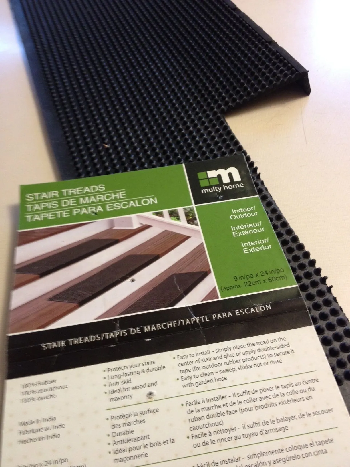

Went to Home Depot and picked up a RUBBER stair tread. There were less expensive vinyl ones available, but the rubber one was much, much sturdier and had a nice 90 degree lip that fits nicely on the edge of the dead pedal. The price was right around 5 bucks. I cut the stair tread to size and attached three strips of 1" wide self-adhesive backed velcro to the back. The adhesive on the velcro stuck really well to the rubber dead pedal cover (notice it is no longer a stair tread). When I put it in place, the velcro strip also seemed to grab the carpet as well. So now it's ready for anything the Canadian winter wants to throw at it.

Heres a picture of the stair tread product I purchased at Home Depot:

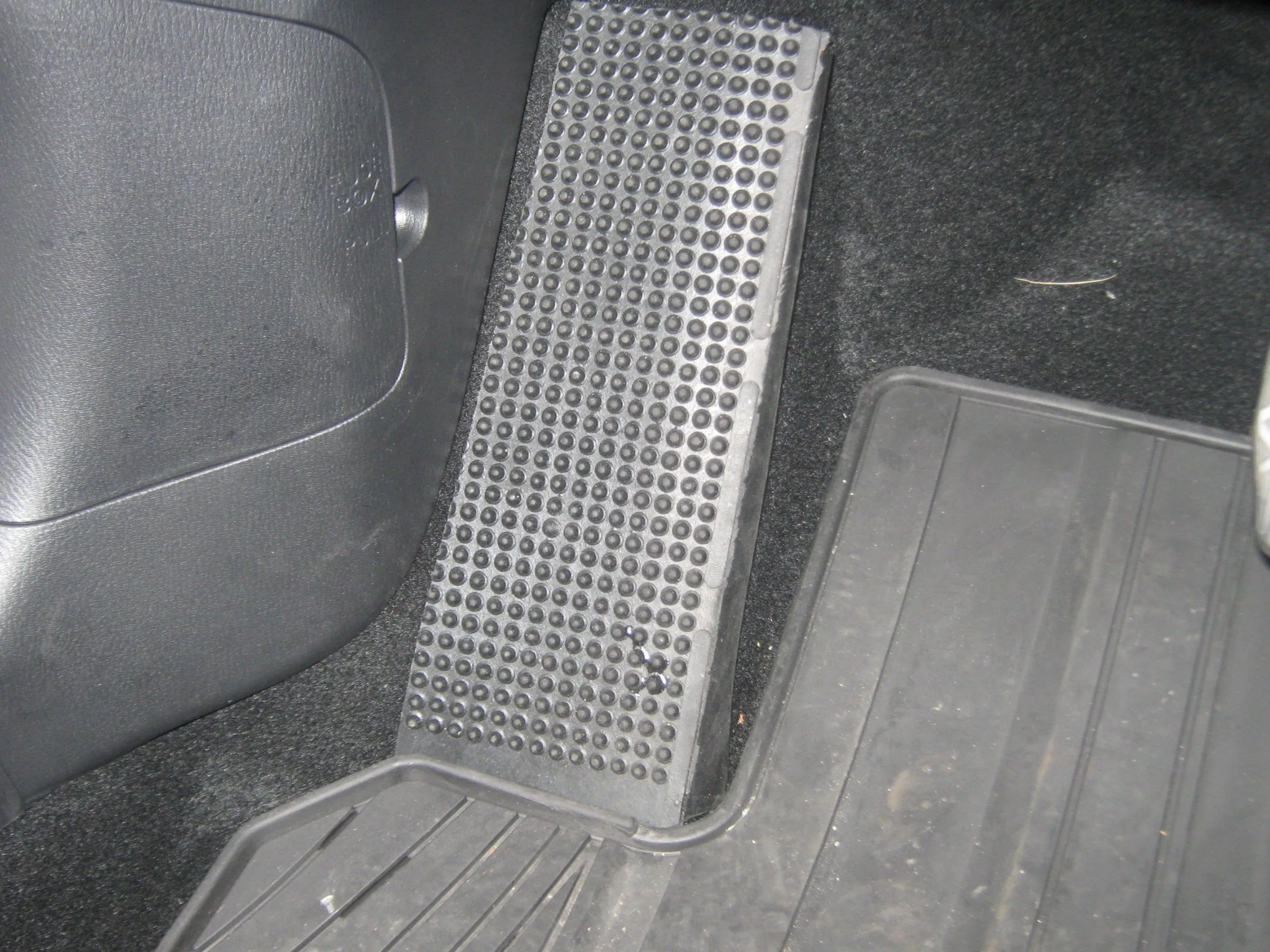

Done a similar thing myself using thin rubber car mat cut to size. You only need to use the "hook" side of the velcro stuck to your "dead pedal cover". The carpet acts the eye side of the velcro gripping it like glue! Mine looks like it was factory fitted!

Noticed you put some rubber mats over the existing carpet mats which is not a good move man, be careful that don't slide around or get in the way of brake/gas pedal. It's a decent look as well but I like the studded ones that Happydaze put up as they come over the lip. Good stuff though...
Thanks Gio. I know the manual says Mats on mats is a big no no but they aint budging believe me. The lipped version upgrade is nice but they are not available in the UK. (lol2)

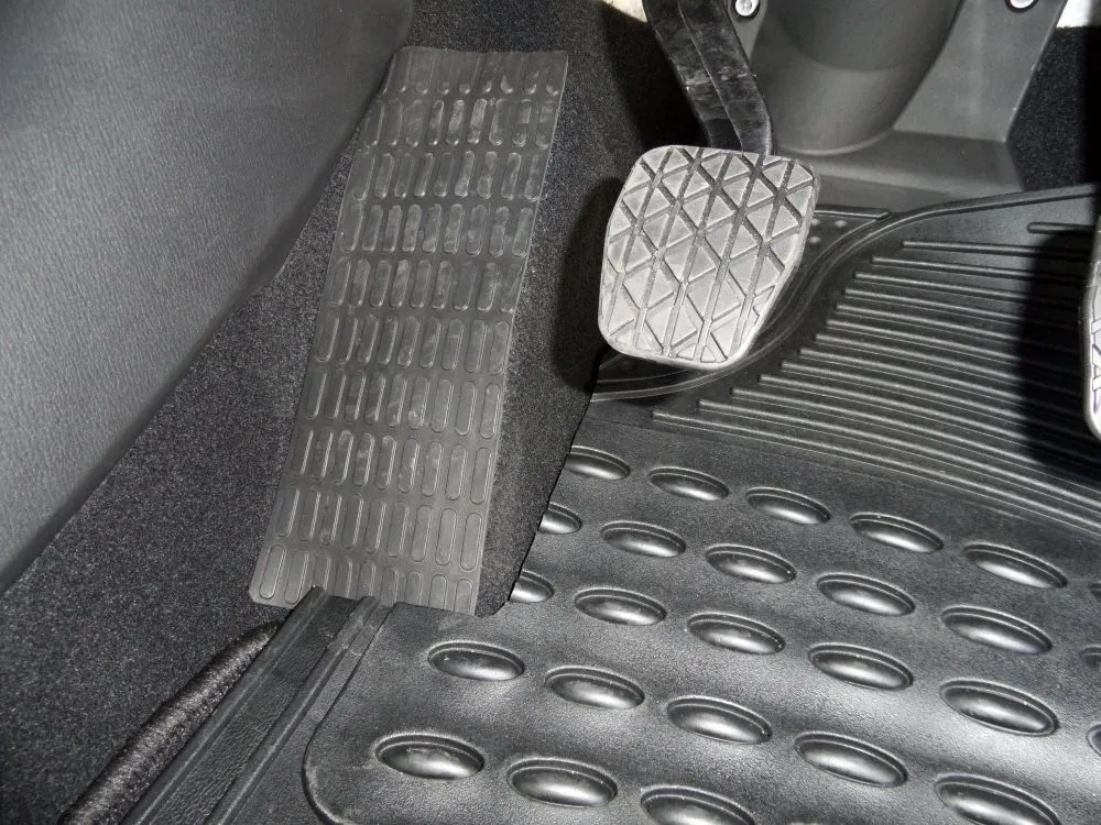

couldn't find anything quite like that on lowes or home depot's site, have to check stores personally, would be great to have over the lip of my weathertechs so anything on them melts/drains into tray
Stealing another's idea, I did the rubber-stair-tread-for-dead-pedal install. During the process I noted that in less than 1000 km the right heel area of the carpet mat was beginning to wear. With lots of materials left over, I cut a rounded corner rectangle the size of the heel insert area on the carpet and - viola! a rubber right heel rest. Seemed a natural progression.
