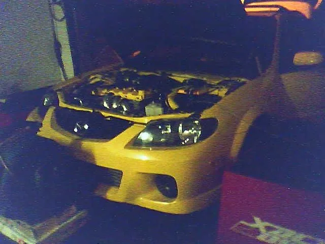

Here is a camera phone picture of it at the dyno.
