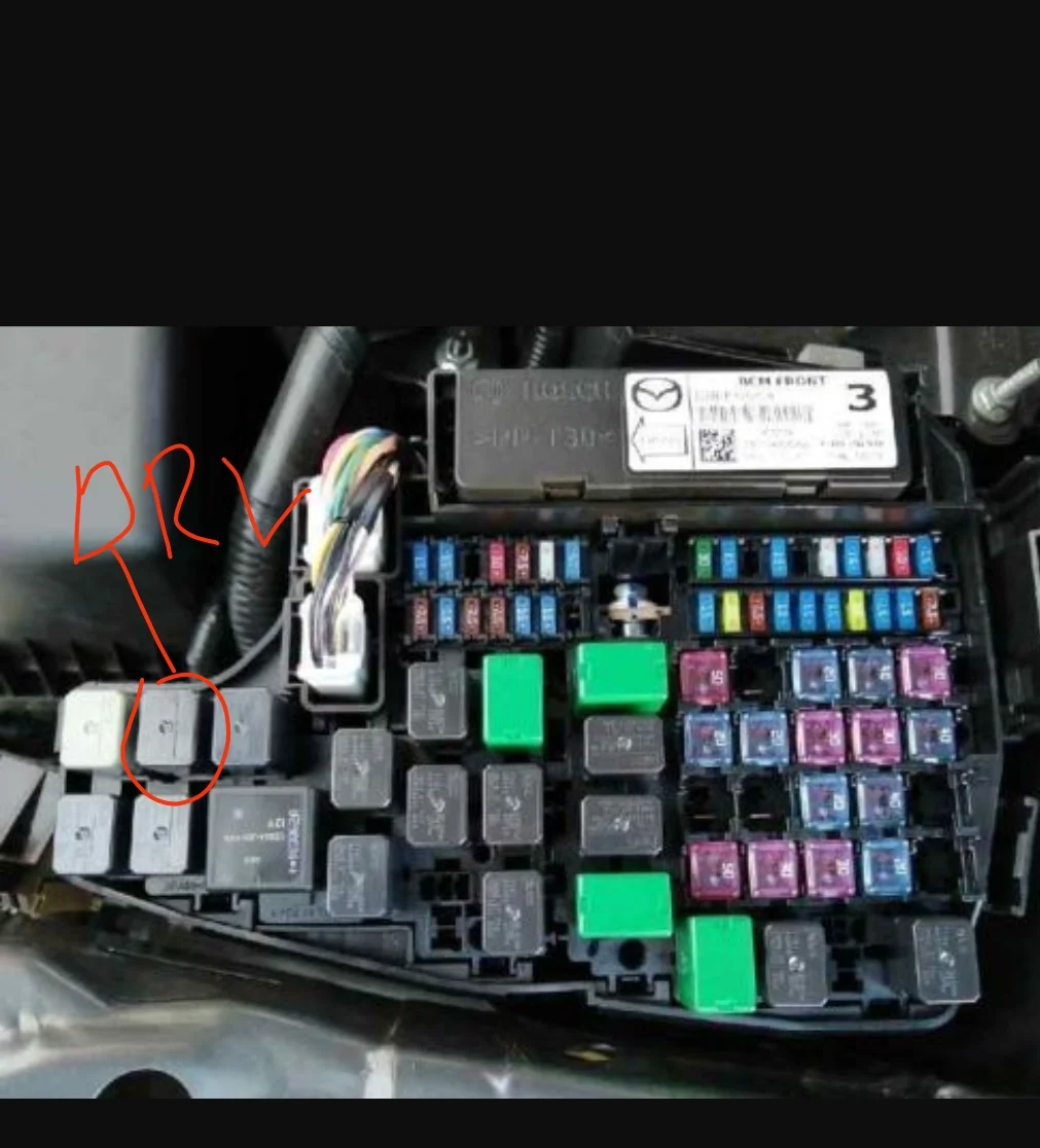

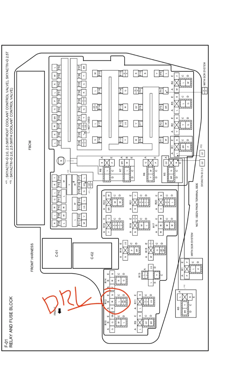

Вы можете просто снять реле.
Translated..."You can simply remove the relay."
With my Canadian version 2022 Sport Design (with Adaptive headlights and halo lights), the DRL relay does absolutely nothing. It's the FBCM that turns on the headlights, either for DLR, Auto or Manual.
Strange, there are 2 ways on my USA 22 turbo to turn off the daytime running lights. One is removing the drl relay in the engine compartment. 2nd is do the procedure. When drl is off, the headlights function as described in the owners manual. In the parking position on the stalk, the halos that surround the main lamp come on. In the US, there is no federal regulation for drl.

Josh, unless your car was made for the Canadian market, you should be able to turn off your daytime running lights. There is a relay in the engine compartment fuse box marked “DRL”. Just pull it out, like a fuse would. Or, there is a way to turn it off by doing a series of flipping the light stalk control and hitting the hazard button while stepping on the brake. When the drl is off, the lights function as described in the manual. On higher trims, the led that surrounds the main lamp (halo) can be turned on with the light control stalk in the parking position. In Auto mode, no lights come on until it is dark enough. If you want the exact process, i can send it to you.
