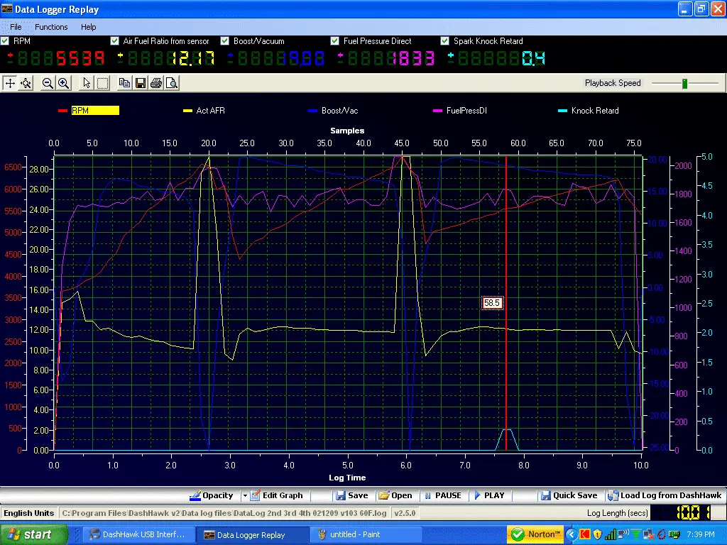

Finally got some logs today, and they show what I feel (and see in the alert) that I have nasty amounts of KR in 3rd. Thoughts on why? Mod's listed in my sig, 93 octane gas.
Screen caps and actual logs from 3rd & 4th (separate pulls) attached.
Thanks!

The second pic 1.4 kr is nothing, but the first one OH CRAP! 7.5 knock retard puls you got that dangerous super lean spot beteween 3-4k thats where everbodies engine is blowing and thats wher your knock is, you bettrer get an cp-e standback asap and add a bunch of fuel in that area befroe she blows... Or add fuel some other way if you know of another way to...
It could be related to you loading the car up at 2500 rpm's. You can see how lean you are when you get the worst knock retard I have ever seen at WOT. Did you hear pinging. I don't suggest doing WOT runs with KR like that. I would say put the stock tmic on and see what happens.
I'm not seeing the lean condition, help me understand that. I did mean start the pull at 3000-3500, I agree that I hit WOT at too low of an RPM.
Couldn't hear it, but damned sure felt it... it just stopped pulling.
You know, the KR has been more active since adding the SU TMIC.
Try to get the one step colder plugs.. What spring do you have on your forge?
Also when you felt it did you see any puffs of black out of the tailpipe?

You are very lean down low.
I would not suggest you going into boost with that much knock happening.
It wasn't until your a/f hit 11's before the knock began to subside.
I would def suggest getting ems to richen up that mixture.
Based on the datalog it does not seem that you need the upgraded cdfp.
You should def re-check all clamps and such and make sure you do not have any leaks.
I would even go as far as to suggest you getting the TMIC pressure tested.
Your a/f ratio is between 13 and 14 when the ecu is pulling all that timing to richen it up. You should be around 12.0 if you were tuned. I agree one step colder plugs should be added asap and you should check for leaks, possible the turbo inlet is loose. What are your long term and short term fuel trims? A would also help the situation and don't load your car up below 3k.
Thanks, I've got some credit at SU from the TMIC purchase, so I have the NGK plugs on the way.
STFT is roughly -5 to +5, probably around -1.6 just normal cruising. LTFT is about -4.7 cruising and -12.5 at idle. I will admit ignorance and say that I really don't understand what is. If there's a "turbos for dummies" post/thread/site, please point me too it!!
I really didn't mean to start so low and I will probably make a new 3rd gear pull from a more suitable RPM, maybe we're just looking at a problem with the fuel pedal actuator. I didn't go full WOT but I did get into it today on the way home in 3rd at a higher RPM and didn't get the KR alert (set at 3).

I am not sure if this is correct but is the knock retard the correct output to be monitoring when looking at knock? Is that signal your cars response to reduce knock? I could have sworn it was another parameter/acronym? I don't own a DH. I hope I am right for your sake. I mean if your car's timing is adjusting especially at lower RPM's and WOT that would make sense but who am I to say I'm jyst questioning.
Yes, it is the correct output to be monitoring. KR is not a measurement of knock, but, as you somewhat put it, the car's response to knock. It is a value, measured in degrees, of how much the spark timing is being retard. So, in the OP's first log, a KR value of 7.5 indicates the the spark timing is retarded ~7 (it may be 7 or it may be 8) from the programmed or 'base' timing map.

Stage2 v103 FMIC log attached....very little kr.

I bet the IC or a clamp is leaking. Boost leaks can cause big KR. If you lo timing along with KR you will see that it does no work like phantom said, although it should. The KR actually seems to be the measurement from the knock sensor NOT the amount of timing being pulled at that moment. Like i said if you log them together you can see that. I have seen up to 5.5 on my KR but the timing does not change. Then on a log with 6.0 KR you can see a big drop in timing. The way the PIDs work are a little funny with the DH sometimes.
Not to seem argumentative, I don't know enough about it, but I don't see what I would consider a boost leak. I do see that the boost tapers off on both runs, but I would expect it to do that.
At the risk of being Mr. Literal again... I would disagree a boost leak would cause knock. A boost leak should, in theory, cause the engine to run rich, which generally helps prevent knock. A leak pre-turbo while under boost would lead to potential lean conditions, but I don't see how leaking off boost would cause knock.
Also, I disagree with the statement that KR is not the timing being pulled. Take a look at this log:
While it is certainly only one log and certainly not conclusive, there appears to be a definitely relationship between the slope of the spark advance and knock retard lines. It is hard to determine at the onset of the knock retard because the engine load is rapidly changing and thus the spark advance is changing. Yet, once I settle into a cruise situation, as the knock retard falls, the spark advance increase. When the knock retard once again increase, the spark advance once again goes down in a corresponding manner. Now, admittedly, for one reason or another the spark advance does have a significant drop with no significant corresponding change in KR, engine load, RPM etc... which admittedly I can't explain. Though not shown, later in the same log from which that image came, I have a similar situation -- the spark advance and knock retard lines are closely correlated.
I would certainly be interested in seeing any logs you have with which to compare data. I also have plenty of log data where it seems like spark advance and knock retard aren't directly correlated... but the key difference is that the engine load and rpm are in a state of significant change and thus the spark advance is in rapidly changing so it doesn't seem to be a situation where one could easily compare spark advance to knock retard with any clarity; since load and RPM are changing the spark advance is changing. In my opinion, a constant load/RPM situation is the best to determine the correlation since the spark advance should be constant allowing for a direct comparison of spark advance and knock retard.
