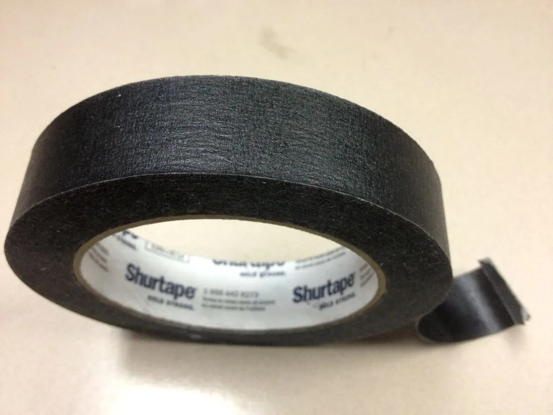

I want to try your solution but I am not sure what black paper tape is and where you can obtain it.
Thanks for your help.
Here is a picture of the tape.
It does not have to be black nor it has to be made from paper either...
I'd bet that regular painter masking tape will do well. All you need to do is create a spacer by folding tape a few times. Eventually it will turn into piece of desired width.
Finally, insert pieces into the slot between dashboard and a-pillar cover. I tucked my pieces in with flat screwdriver. All should not take more that 5-10 minutes.
Hope this helps.
