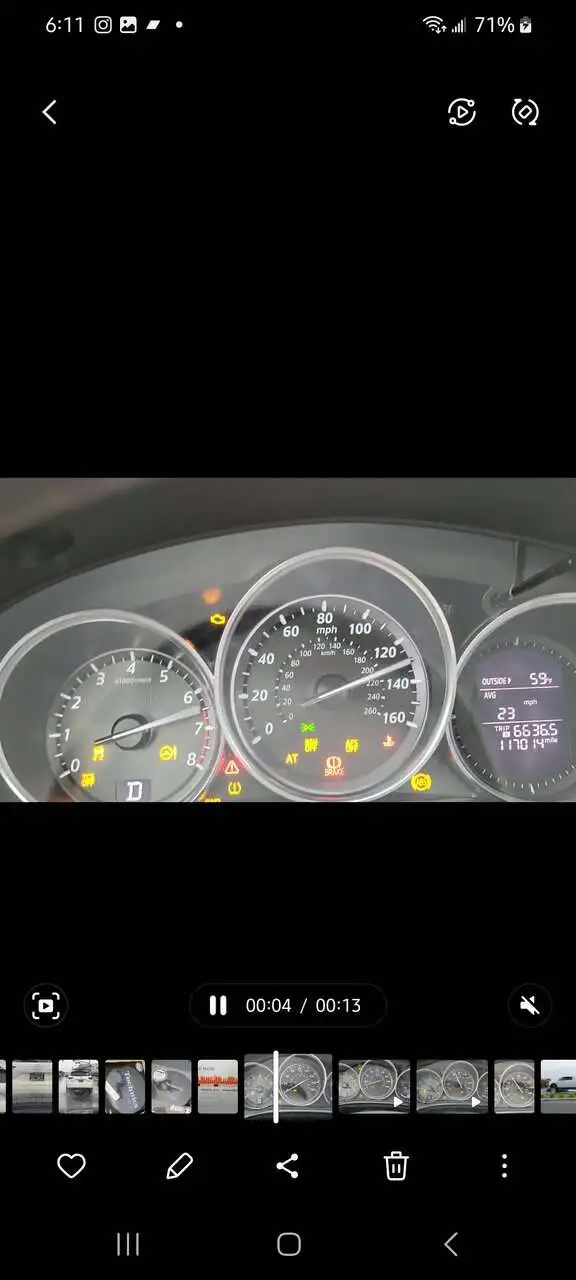

Not too sure what's going on with my cx-5. No warning or anything. But driving 60mph after just getting on the fwy, my needles redlined, and all my dash lights flashed. Car lagged for a second, and keep driving. All ABS and check engine lights stayed on, the rest turned off. I parked, turned it off for a few hours, started it again, and all lights went off. Drove around the block, and check engine light came back on. I misplaced my reader, and auto zone doesn't want to loan there's out in the rain. Battery was just replaced, and it starts right up, so I'm ruling out bettery and alternator.
I've made an appointment with Mazda, but don't want to show up not knowing what's going on, then get robbed. Hoping someone has experienced this issue, and can point me in the right direction. Pic attached.

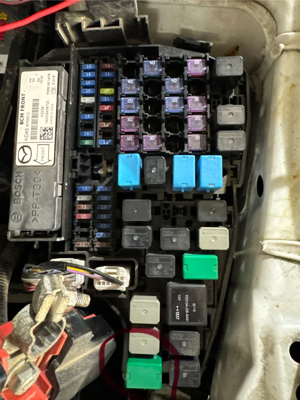

I found my code reader after digging. P0685 code. Going to a local shop before the dealer. Hopefully it's an easy fix.
If anyone ever comes across this issue. This could be one reason.
