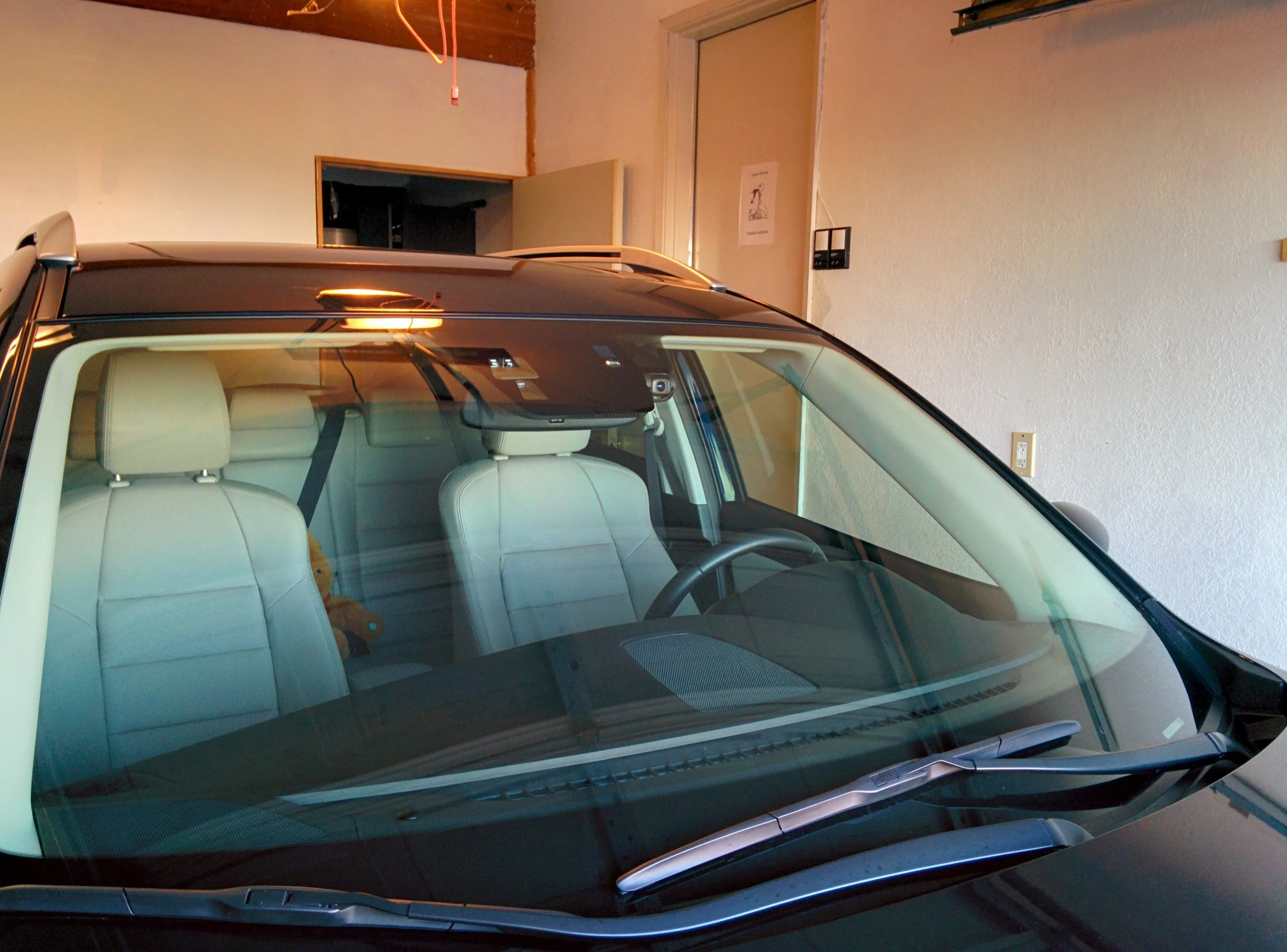

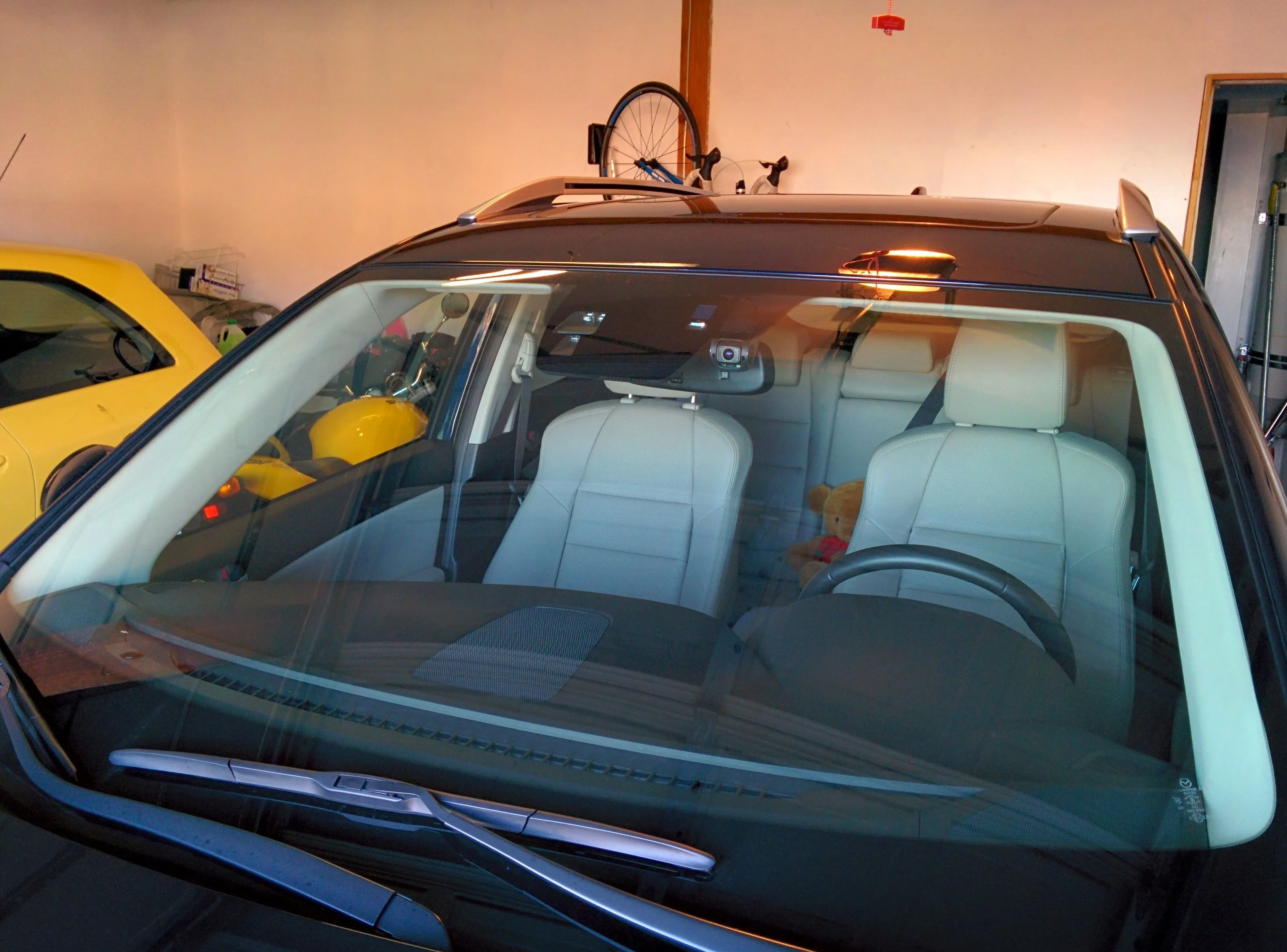

I have had a Mini 0801 mounted on the sensor cover for over a year now. I have just removed it and waiting for the new A118 to arrive.
I will place it next to the sensor on the left side where the black spots are. I believe this shape of dashcam is the best for the future, for placement, etc..

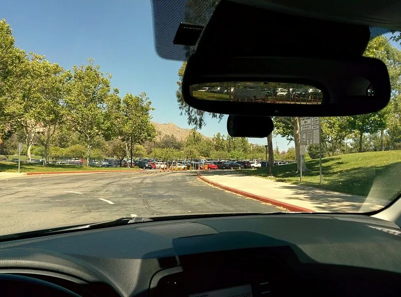

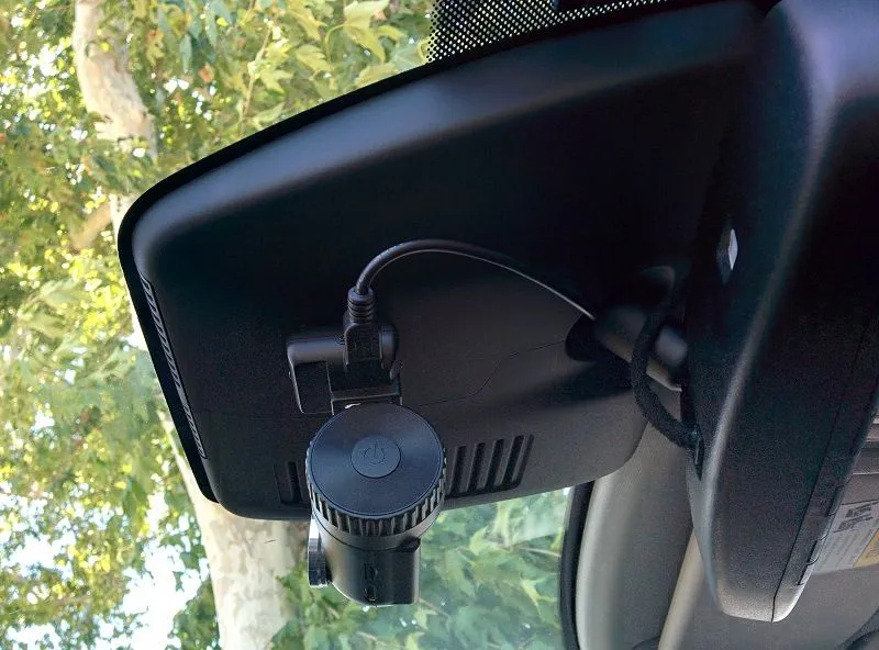

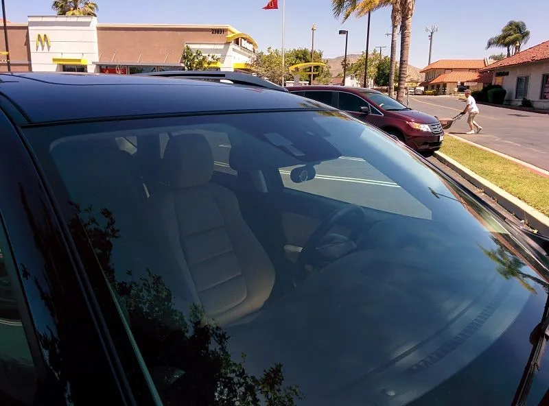

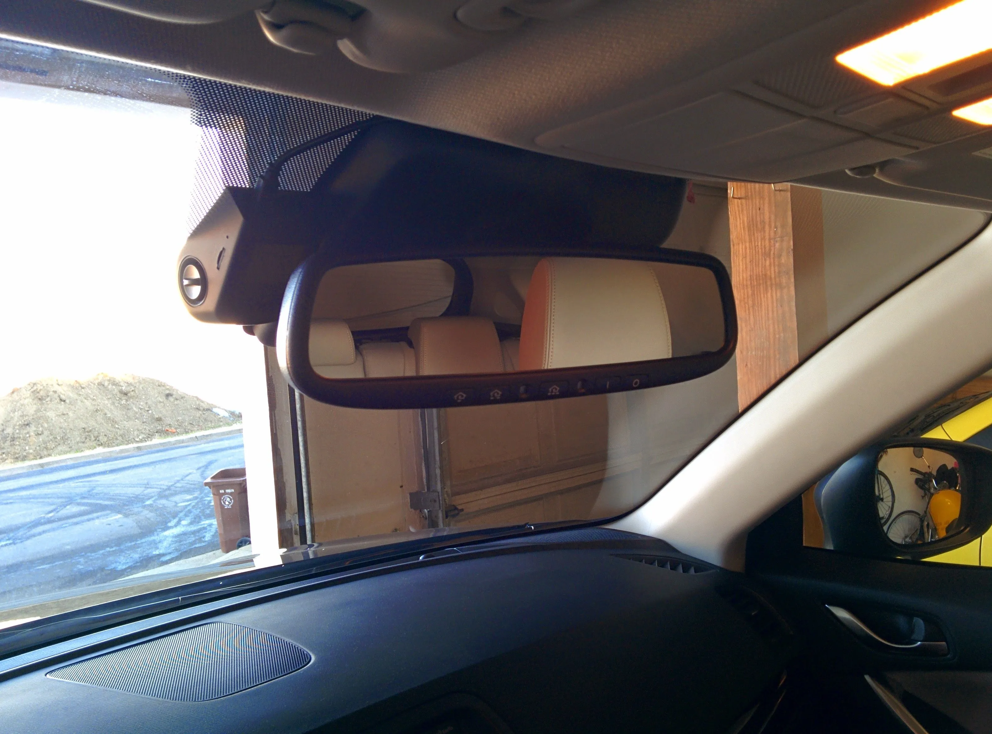

Here are the photos of my Mini 0801/0803 mounted. I've taken it off last week and waiting for the A118.

Thanks! I think I would mount it next to the mirror and higher up. Do you have both the mini 0801 and 0803? if so, which is better? I have been reading reviews that show the 0803 has a clearer image & better night vision, but there have been a lot of reported problems with it shutting down/not starting and even MELTING. I would want to avoid that headache and go with what appears to be a tried and true 0801 where all the kinks have been worked out.

It's mounted that way because of the huge sensor cover area. On the sides, because of how the 0801 is shaped and works, it was the best place for center view and coverage. The camera points to the right from the mount, so putting it on the left side of the sensor area, it would be way off center, and putting it on the right side it's too exposed.
I have the 0801 original. My friends have the 0803. Their mounts seems very sturdy and tight. Mine is loose and wiggles, and with the heat, if I don't check it once in a while, it'll fall off when i make a huge wide turn. No melting issues and I live in southern california.
